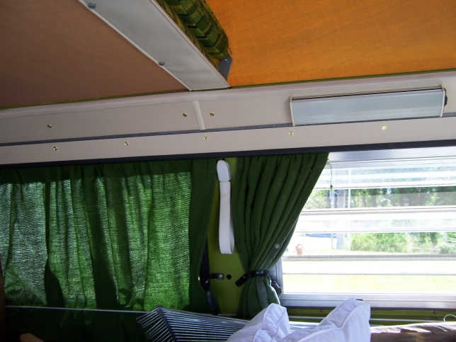

Our 1979 Westfalia Bus, is totally unrestored, and in very nice condition. It has Green rough Burlap type Curtains, which I can do without. They look like they might regenerate into dust soon as it is. Looking on the Web the few curtains I could find Started @ $150 a set and went up from there. That was for the same burlap type of material. We liked the idea of a heavy tapestry lined in white to cut down the heat.

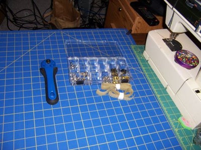

You will need:
a Sewing Machine,
an Iron,
a nice sharp Shears or Cutting wheel,
Snap setter (A Must! You can change a lot of the snaps to Velcro as I did, But you need Snaps for the big Front Window Curtain. Velcro won't hold the weight.)
Measuring Tape

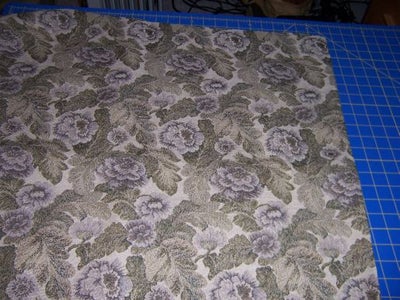

I used 6.5 yards of 60" wide fabric for my main color, 30" of that was lost to Pattern matching.I Started with 8.5 yards not knowing how much I would need.

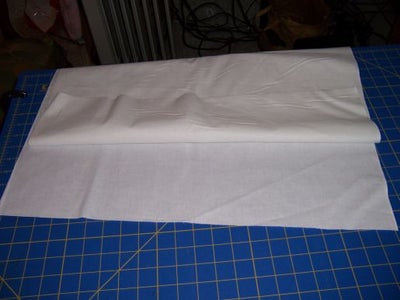

Liner Fabric, I used 6 yards of 45" wide white cotton.

Snaps, These are not the snaps in the fabric store, these are for automotive uses. one side has a screw in it for attaching to a surface. I found mine in Lowes.
Snaps, regular type for the middle section of curtain. (this is optional, you can use velcro here too, I didn't, I stayed with the snaps)

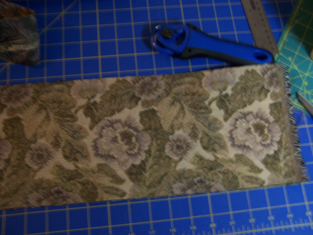

Due to the thickness and weight of the Fabric and Liner combined, I decided to change the dimensions of our Curtains. So my finished sizes are slightly smaller than the originals. The Front Window and Sliding Door Curtains, I did not change. But all the other curtains are 27" wide instead of 30". The curtains still more than cover the windows nicely, and have that pleasing bunched effect when open. It doesn't affect the directions, but it gave me an advantage in that I was able to get 2 curtains from each cut of my 60"W main Fabric. I was concerned at first because I was losing fabric to match the Pattern, so that every curtain is inline with the last. This might not be an issue , but I was trying to match a 20" repeat and a 24" cut of fabric. I lost approx. 7" for each cut of Fabric. Some of this I was able to reclaim for the tiebacks.
But not much.
Step 4: Cut Cut Cut
I did all my cutting at the same time, so that I could match my Pattern up. The main thing is to get it laid out straight so that your cuts come out strait. This heavy fabric has a mind of its own, it wants to lay with its grain and if it is cut crooked it will show, you cant train it with an Iron like a light weight Fabric. This can help with cutting, but when you are wrestling 6-8 yards of Fabric it gets tricky. After you get it laid out nice straight and even, just cut it in 24" lengths all the way across the width. You will need 3 cuts just for the Big Front curtain. 1 for the sliding door, and 1 cut for each set of 2 curtains. ( If you are doing the full 30" wide curtains, your layout will be length wise of the Fabric. I cut across the width.)
8 peices of cut fabric in all.
The Lining Fabric is 45" wide so after cutting the edges off, I just cut the long peice right down the middle all the length and that gave me 2 long peices of 22" Fabric.

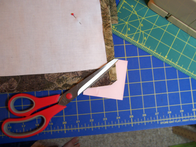

After the hem is sewn, The side seams are next. The liner Fabic is slightly smaller than the Main Fabric, this makes it easier to fold the side seams without making the liner bunch up and wrinkle. Fold Fabric over 1", then fold 1/2" of that under and pin all along the edge nice and straght. At the corners cut 1/2" off at an angle, and cut off as much excess material at the corners, this will help the edges lay flat, and more importantly, help your machine sew to the edge, without hitting a huge mound of material and breaking your needle.

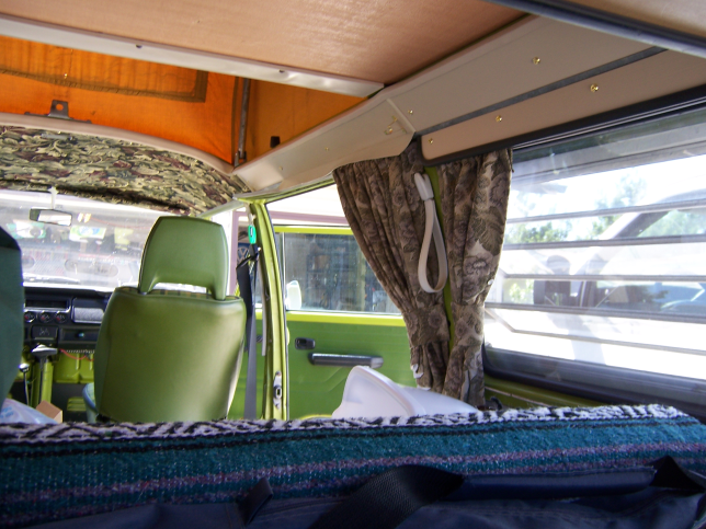

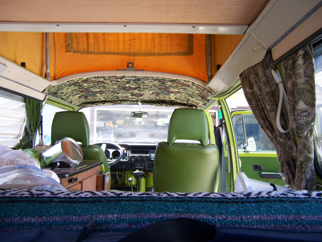

All thats left are the snaps. These need to be placed where yours are so measure carefully. The snaps come with complete intructions, plan on needing a strong arm. I think the original snaps might be metric, I had to replace the snaps on wall even though the old snaps looked to be the same size as the new ones.
They came out pretty nicely.
