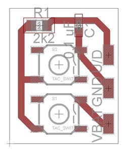

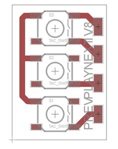

Step 2: Making the Boards
For this step you need to download the eagle designs from the previous step. And you need to make and assemble this boards. I am assuming that you know how to interpret the designs and get things done. So i will be short in this step.
Note: I used a JST connector for the lipo battery. The 3.6v regulator is not necessary, I included it for powering the bluetooth module but it give me a lot of brown out power problems.
