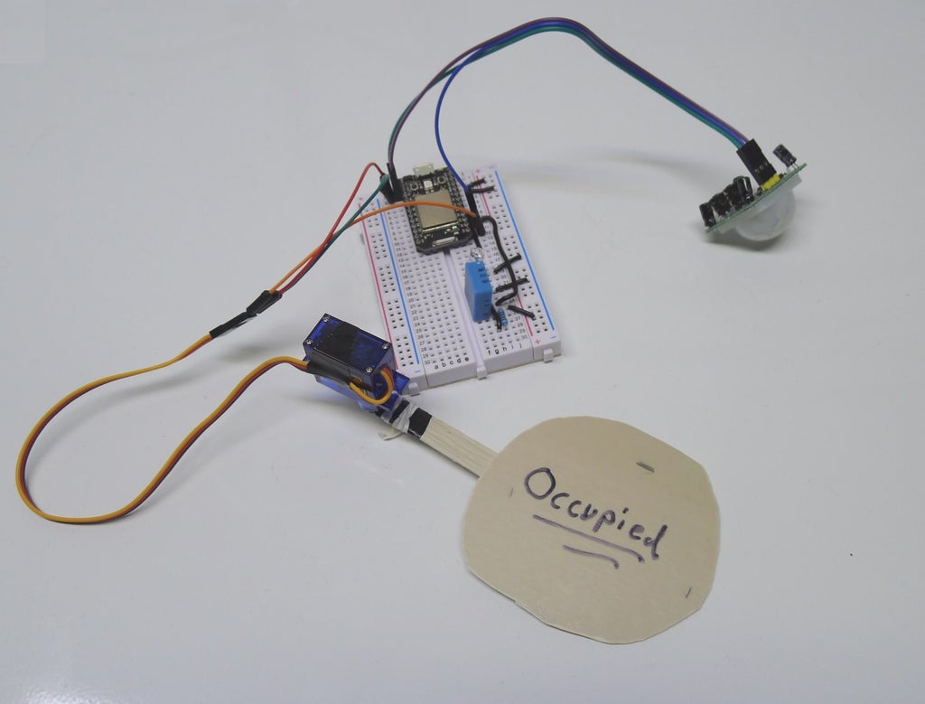

Wire up the Spark Core breadboard circuit following this wiring diagram. Click to enlarge.
Your circuit should look something like this.
I included a temperature sensor in the circuit because they're so inexpensive.

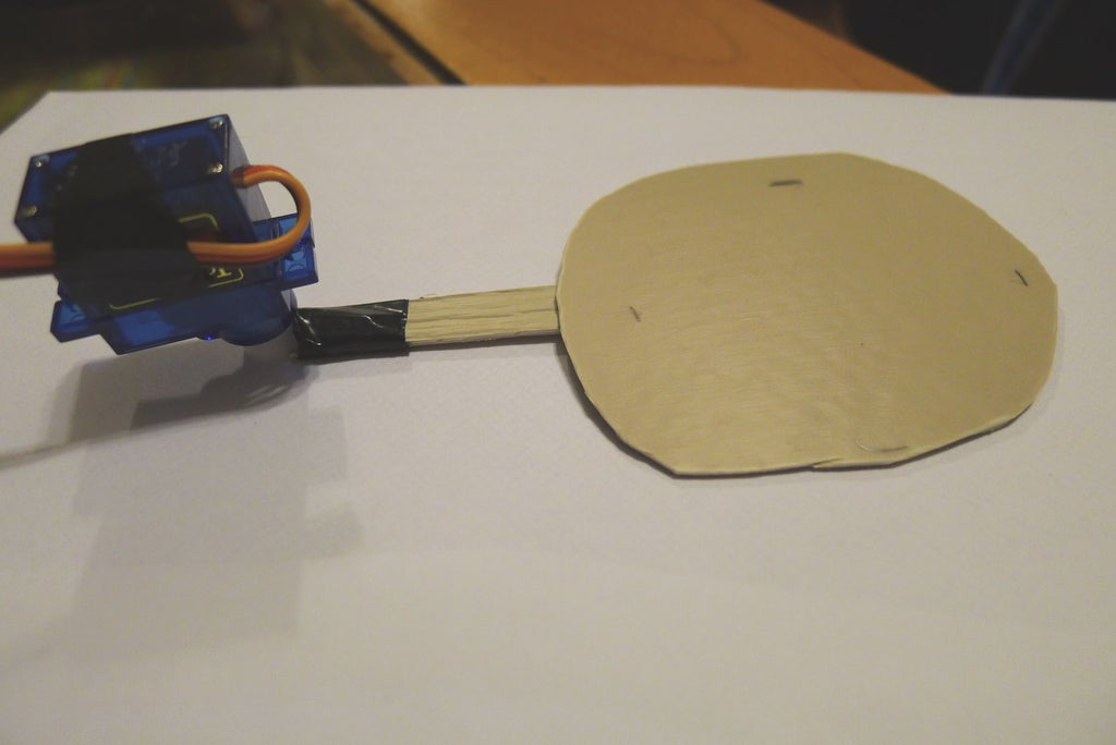

Step 2: Assemble Trap Arm
Next, we need to assemble the trap arm using the servo. The trap arm is what moves the "occupied" door in and out of position, and prevents more than one mouse in the trap. I'll show you the end result of this step, and then detail how I made it. You may take liberties with the supplies you have available.
This video is looking at the underside of the card board top. You can see how the arm moves the door into position, and latches it in place.
Cut the card bard into shape (with a hole big enough for a mouse to fall through). Cut some pieces for an arm and a door and attach to the arm of the servo. For the parts, I used left over vinyl siding material. You can use sheet metal or any other flat, stiff material that you can cut to shape. It should look something like the following series of pictures.
Cut a hole roughly the shape of the servo motor. Poke the servo through the card board. The servo should rest on the extra plastic protrusions and not fall through.
Create a sort of slanted latch for the door, so that the door gets "locked" into place and the latch helps hold it in, in case mice from above want to get in.
