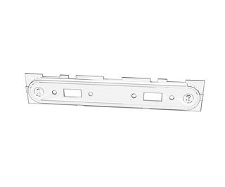

Then I reproduced a more simple front panel on Sketchup and placed two USB connectors instead of the normal ones. I printed the piece on a friend's 3D-printer, removed the plastic needed to print correctly and fixed the USB connectors.
Finally, I tested the piece in place.
