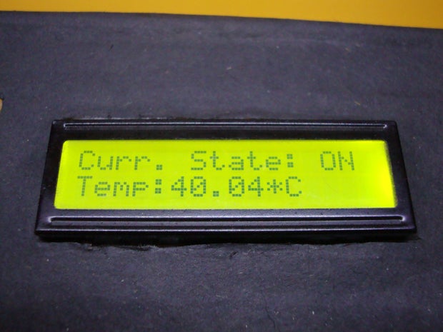

2) Temperature Sensor Mode: Uses the temperature sensor to control the outlet by switching it on when the actual temperature crosses the set threshold temperature. This mode can be used to run, ceiling fans, desktop fans, room coolers, low power air conditioners and any appliance related to temperature. The arduino code can be modified to use it for heating appliances.

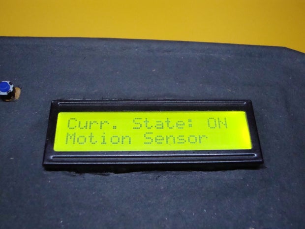

6) Motion Sensor Mode: Uses a PIR motion sensor that detects the motion of a human being. Use this mode to turn on an appliance by just waving your hand in front of the box upto a range of 6 meters. Wave your hand again to switch it off. This mode can be used to control almost any appliance.

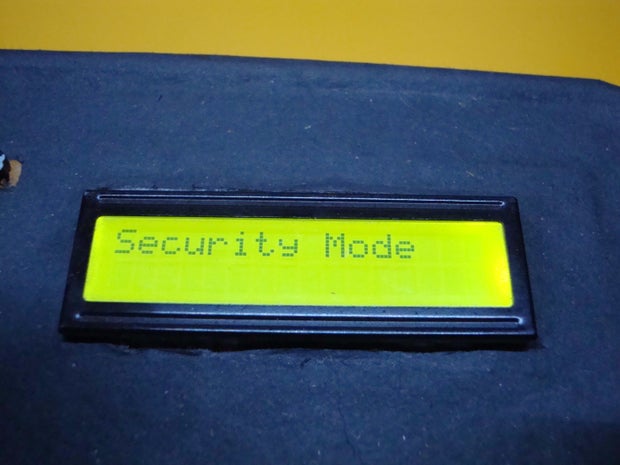

8) Security Mode: This mode can be used to protect your valuables at night when you're sleeping. It uses the motion sensor to detect the motion of a thief at night. On detecting a thief, it switches on the outlet and sets the buzzers high to wake you up. You can connect a light or a loud bell to wake you up easily.

  3. The security mode will beep the buzzer even if you or any other person (who is not a thief) passes through the front of it spoiling the sleep of your family members.

  1. Temperature sensor (LM35): Gives a voltage on one of its pins which becomes high or low depending on the temperature of the sensor. The arduino reads the voltage and converts it to readable temperature.

  5. Motion Sensor (PIR Sensor): Detects the motion of a human and gives a high output when detected. Actually detects that radiation given out by a human.

Step 8: Connect the PIR Motion Sensor
PIR motion sensor is a device that can detect motion of a human up to a range of 6m. PIR stands for passive infrared. It works on the principle that every human emits a radiation of certain wavelength. The sensor detects those radiations and gives a high output when a motion is detected. So here when you will wave your hand in front of it, the outlet will get switched on. It is also used in security mode at to detect motion at night. Connect the sensor according to the text given below To check your sensor, upload the code given below to your arduino.
  1. Vcc ---- Arduino 5v
  2. Gnd ---- Arduino gnd
  3. Vout ---- Arduino analog pin 1

   lcd.print(thres1);
   delay(100);
  Serial.print("Threshold Temperature: ");
  Serial.print(thres1);
  int a = 0;
  while(a == 0)
    temp = analogRead(temppin);
    temp = temp * 0.48828125;
    lcd.clear();
    lcd.print("Curr. State: ");
    lcd.print(state);
    lcd.setCursor(0,1);
    lcd.print("Temp:");
    lcd.print(temp);
    lcd.print("*C");
    if(temp >= thres1)
      digitalWrite(13, HIGH);
      state = "ON";
    if(temp < thres1)
      digitalWrite(13, LOW);
      state = "OFF";
    delay(1000);

   case 6: // motion sensor mode
     Serial.println("Motion sensor mode selected");
     for(int b=30; b>0; b--)
       Serial.println("Preparing Sensor.....");
       lcd.clear();
       lcd.print("Preparing");
       lcd.setCursor(0,1);
       lcd.print("Sensor...");
       lcd.print(b);
       delay(1000);
     int a4 = 0;
     while(a4 == 0)
       lcd.clear();
     lcd.print(state);
     lcd.setCursor(0,1);
     lcd.print("Motion Sensor");
       if(digitalRead(pir) == HIGH && state2 == 0)
       state = "ON";
       state2++;
      delay(4100);
   if(digitalRead(pir) == HIGH && state2 == 1)
     state = "OFF";
     state2--;
   delay(4100);
 delay(100);
   break;</p><p>case 7: // presence sensor mode

  break;</p><p>case 8: // security mode
  Serial.println("Security mode selected");
  Serial.println("Preparing sensor.....");
  delay(1000);
  for(int d = 30; d > 0; d--)

  lcd.print("Security Mode");
  delay(10000);
