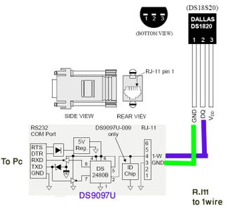

1-wire is bus network, and should be wired in a daisy chain manner, not hub and spoke, in other words devices should all be connected in a row, not all fed back to the serial port adaptor indivdually. (But you can do this with 1-wire hubs)
Wire up sensors, connect serial port adaptor, make sure pin out is correct, and reverse 1-wire and gnd.

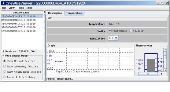

open the following website, and run the 1-wire viewer,
it will show you all the 1-wire devices connected after you configure the correct interface type and serial port.
http://www.maxim-ic.com/products/ibutton/software/1wire/OneWireViewer.cfm
If you don't see any listed you may have it wired incorrectly, either way don't proceed until you see your devices listed like the screenshot.

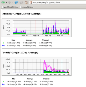

Install Perl first, then MRTG, then Apache. Search the web for excellent guides on getting MRTG up and running, its a great tool for monitoring routers,switches, and just about everything else. The only thing to remember is that the vanilla mrtg install can only graph 2 values per graph, an in and out, (you can graph multiple if you switch to rrd or other tools,but this is the simplest way to get started)
ActiveState Perl (Free) http://www.activestate.com/products/activeperl/
Then download latest stable releas of MRTG, (read docs!)
basically you unzip, go into mrtg/bin you will need to create a mrtg.cfg, I did not include a full mrtg.cfg file, only the section for 1 pair of sensors, so basically create the cfg and cut and paste the section I included, keep in mind you have to change you serial numbers based on your sensors!
MRTG (Perl Script)(Free) http://oss.oetiker.ch/mrtg/
Normally you run the cfgmaker script, but because this is a custom monitor, we will need to cut and paste the mrtg.cfg portion I included on the first page. After that run indexmaker, and it will create a simple little index page. Point Apache at your MRTG folder so you can access the pages from anywhere..

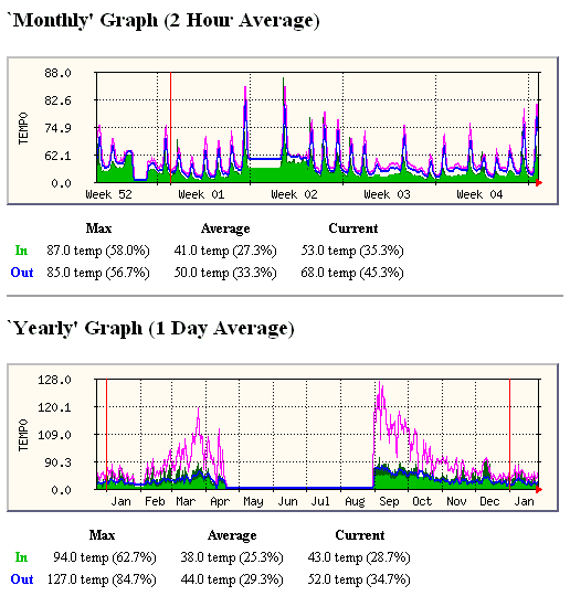

I also decided to graph my attic temperature as I was debating on installing a ridge vent. It's interesting to compare the attic versus the outside temperature, as the temperature is strongly related to sun exposure. Sudden rainstorms show a sharp drop in attic temp, while outside temperature will vary only slightly.
Some insulation studies seem to graph only the difference between outside and indoor temperatures, this could easily be done using variables in the mrtg section config.
In addition to using misterhouse and x10 to manage my home, I can pull up a webpage showing temps all around my house on my web phone. I also integrated my alarm system so I can graph motion in the house with MRTG as well, A definite geek feature..
