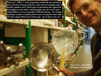

As part of an altruistic 2004 NZ student project,it was realised cheap USB WiFi adapters, in conjunction with reflective parabolic cookware, could offer a cost effective workaround. The USB approach appealed since -

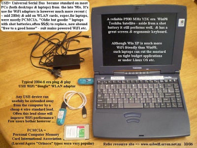

  • All the microwave-data decoding is done right in the USB "key", so no cable losses occur.
  • Regular cheap USB extension cables (to some 5m) & connectors can be used to locate signal localised sweet spots, perhaps with auditing software such as Netstumbler.
  • USB "keys" are cheap (~US$10),although their power output may be low (~40mW).
  • Easy swap outs for testing assorted reflectors & adaptors results.
  • The USB keys can readily be mounted at the focal point of suitable parabolic reflectors, yielding gains of ~12dB at little cost with just cookware,sieves,woks or the like. Such gains can extend line of site (LOS) ranges to several km.

Step 2: Parabolic Asian Cookware!
Reflective devices for 2.4 GHz WiFi abound- pot lids,sieves,lamp shades etc! Asian cookware is sturdy,cheap & easily modified

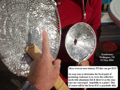

Step 5: Reflecting Sunshine to the Parabolic "hotspot" Also Helps Locate the Focal Point
Reflecting sunshine to the parabolic "hotspot" also helps locate the focal point

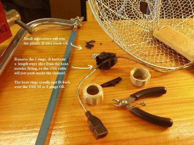

Step 6: Support the USB WiFi Adapter & Lead With a Cheap Garden Hose Connector!
Support the USB WiFi adapter & lead with a cheap garden hose connector!

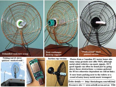

Step 8: Portable or Indoor Use- Simple Supports.
Portable or indoor use- simple supports.
Step 9: Boutique Version- Flexible Lamp Stand. (Netstumbler Shows ~12dB Gain = 4x Range!)
Boutique version- flexible lamp stand. (Netstumbler shows ~12dB gain = 4x range!)

    9 years ago on Step 5
    I wonder if keeping the foil on would improve the signal strength? It could only be used inside, but it might be worth experimenting with.
    0
    manuka
    manuka
    Reply 9 years ago on Step 5
    If the mesh gaps are better than ~ 1/10 a wavelength it makes no real difference. At 2.4 GHz this translates to about ½ inch ( ~ 12.5mm) minimum hence- anything better than that will be "seen" as a solid screen by the RF. Naturally more open designs are lighter & far less wind prone too.

    tinkertoymania
    I used an old dish network dish and installed the usb adapter in the old lna tube. this works great but make sure to adjust the dish to horizontal you don't need the angle up. the higher you go up with your dish the better and you can turn 180 in either direction usually you can pick up 5 to 20 free internet points.
