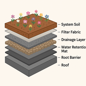

Structural Layers (bottom to top):
  1. Root barrier membrane
  2. Water retention fleece
  3. Drainage layer
  4. Filter fleece
  5. Substrate soil (systemerde, suitable for roof gardens)
  6. Decorative pebbles (for the edges)

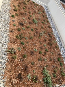

Step 1: Prepare the Roof Layers
On top of the flat garage roof (ready with drainage through rain tubes), we applied the following layers in sequence:
  1. Root barrier membrane – protects the structure
  2. Water retention fleece – holds moisture
  3. Drainage layer – prevents waterlogging
  4. Filter fleece – stops soil from clogging the drainage
  5. Substrate soil (systemerde) – around 10–15 cm thick
  6. Edge pebbles – help retain soil and give a neat border
This created a functional and water-managing base for our plants.
Step 2: Plant the Wildflowers
We arranged and planted the wildflowers in clusters and rows, with space for them to expand. The species were selected for:
  1. Low maintenance
  2. Drought resistance
  3. Long blooming periods
  4. Attracting bees, butterflies, and other pollinators
The entire planting was done by hand — no heavy machinery needed. The rain-fed setup requires no irrigation beyond extreme dry spells.

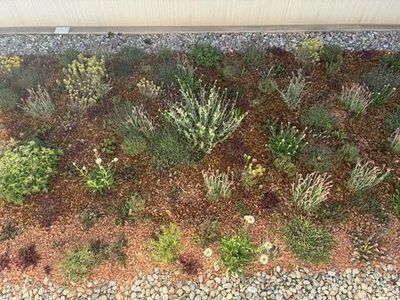

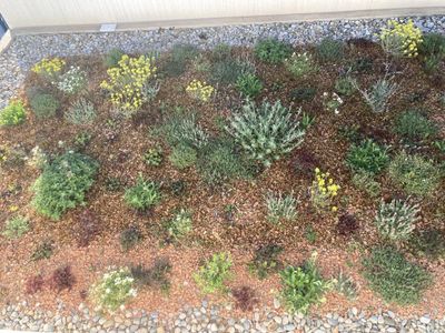

Step 3: Let Nature Do the Rest - Final Thoughts
Over the seasons, the roof has become a living ecosystem:
  1. Bees and butterflies moved in quickly
  2. The flowering changes from month to month
  3. Self-seeding and new wild arrivals appear year after year
  4. The roof helps insulate the garage and adds beauty from above
No ongoing tools or upkeep — just enjoyment and observation.
Creating a green roof is easier than it looks — and incredibly rewarding. This project transformed a dead surface into a blooming, buzzing landscape that helps our local ecosystem and contributes to a greener planet.
