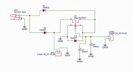

Step 1: πŸ“ Circuit Diagram Explanation
  1. The DC Adapter (12V) is connected through a Schottky diode (D1 - 1N5822), which provides power to the load and prevents reverse current from the battery.
  2. The Battery (12V) is connected via D2 (1N4007), which only powers the load when the adapter supply fails.
  3. A Relay (SPST) is used to control the changeover between Adapter and Battery supply.
  4. D3 (1N4007) is placed across the relay coil to prevent back EMF damage.
  5. Two 1000Β΅F capacitors (U2, U3) are connected across the load to smooth out voltage fluctuations and ensure stable output.
  6. When the adapter is present, the relay energizes and directly powers the load.
  7. When the adapter fails, the relay de-energizes and automatically switches to battery supply without manual operation.
This ensures seamless switching between Adapter β†’ Battery β†’ Load.

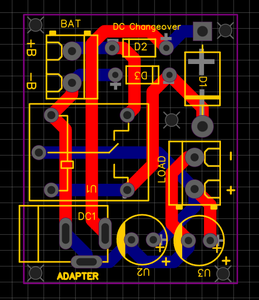

Mount the relay on a PCB or breadboard. Connect the coil pins (85 & 86) to the adapter supply.
Step 3: Connect the Diodes
  1. Connect D1 (1N5822) from Adapter + to Load.
  2. Connect D2 (1N4007) from Battery + to Load.
  3. Connect D3 (1N4007) across relay coil for protection.
Step 4: Add Capacitors
Solder 1000Β΅F capacitors across Load + and GND to reduce voltage drops during switching.
Step 5: Connect the Load
Finally, connect your DC load (WiFi Router, Fan, or Light) to the load output connector.
