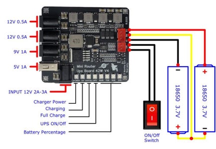

Step 4: πŸͺ› Circuit Description
Discover Easy, Affordable, and Reliable PCB manufacturing with JLCPCB!Register to get $70 New customer coupons:https://jlcpcb.com/?from=EST
Special Deal: Get a $30 coupon for JLCPCB premium 6-layer PCBs: https://jlcpcb.com/6-layer-pcb?from=getcoupon
  1. Power Input Section – The 12V adapter powers the circuit and charges the batteries simultaneously.
  2. Battery Management Section – The 2S BMS ensures balanced charging, overcharge and discharge protection.
  3. Boost Conversion Section – XL6009 ICs step up battery voltage (7.4–8.4V) to fixed 12V and 9V outputs.
  4. Auto Changeover Section – Schottky diodes switch power sources seamlessly when the input fails.
  5. Indicator Section – LEDs display charging, full battery, and UPS ON status.

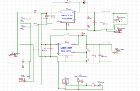

Step 6: πŸ“ Circuit Diagram
This schematic includes two XL6009 boost converter modules, 2S battery pack, auto changeover diodes, and LED indicators for charging states.

Step 8: πŸ”‹ Battery Pack Wiring
Step 1: Connect two 18650 cells in series (B+, B–).
Step 2: Connect BMS board between cells (B+, B–, BM).
Step 3: Connect B+ and B– from BMS to UPS board.
Step 4: Use a 2-pin JST connector for easy removal.
Step 9: πŸ”Œ Output Connections
DC1: 12V Output (Router)
DC2: 12V Output (ONT)
DC3: 9V Output (Switch)
USB Port: 5V Output (Wi-Fi Dongle / Charging)
Step 10: πŸ’‘ LED Indicator Description
LED1 (Red): Charging
LED2 (Green): Full Charge
LED3 (Blue): UPS ON
LED4: Battery Percentage (Optional)
