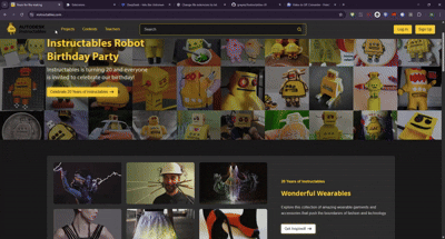

Instructables is turning 20 — and what’s a party without decorations? Instead of balloons, I decided to bring a gift: a Dark Mode Chrome Extension for the Instructables website. With golden accents and glowing buttons, it gives the site a midnight-party vibe while being easier on the eyes.

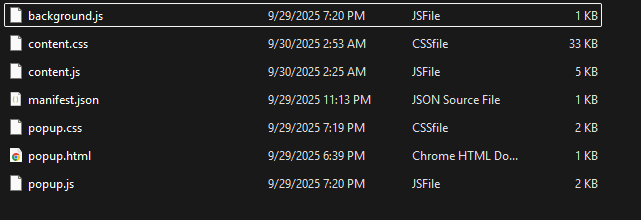

Step 1: Create the Extension Folder and Files
Here’s the folder layout for the extension:
/instructables-dark-mode/
│── manifest.json
│── background.js
│── content.js
│── content.css
│── popup.html
│── popup.css
│── popup.js
Each file has a role:
  1. manifest.json → describes the extension to Chrome.
  2. background.js → keeps track of dark mode status.
  3. content.js → applies/removes the CSS when enabled.
  4. content.css → holds the complete dark mode styles.
  5. popup.html / popup.css / popup.js → create the extension’s toggle interface.

Step 3: Make the Background Dark
  1. In content.css, add your dark mode styles, for example:
body {
background-color: #121212 !important;
color: #f5f5f5 !important;
  1. This turns the page background dark and text light.
Note:At this point, the website may not look very good. Many elements will clash with the new dark background. Don’t worry — the next steps are all about customizing the styles and fixing these “bugs” to make it look smooth and polished.

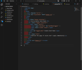

Step 4: Add the On/Off Button in the Popup
  1. Make three files:
  2. popup.html → contains the button
  3. popup.css → styles the button
  4. popup.js → makes the button turn dark mode on and off
This allows users to toggle dark mode directly from the extension popup.

the html file :
<!DOCTYPE html>
<html>
<head>
<meta charset="utf-8" />
<link rel="stylesheet" href="popup.css" />
</head>
<body>
<div class="popup-container">
<h3>Instructables Dark Mode</h3>
<div class="toggle-container">
<label class="switch">
<input type="checkbox" id="darkModeToggle" />
<span class="slider round"></span>
</label>
<span id="toggleLabel">Enable Dark Mode</span>
</div>
<div class="info">
<p>Refresh the page if styles don't apply immediately</p>
</div>
</div>
<script src="popup.js"></script>
</body>
</html>
