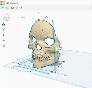

  3. Small skull mask, buy from dollar store or DIY, (I modified a 3d print model from Zet23t on thingiverse, thank you) using Autodesk Tinkercad, so it prints better with glow in the dark PLA with no supports needed. Edited .STL File attached if you want to do it that way.

So, we need a simple splash guard that looks great, stops the splashing and lets the fog crawl out underneath it. You could go back to the dollar store and just buy a skull mask or even use a margarine tub if you want, but where's the fun in that.
My solution was to download a skull mask model from thingiverse and modify it with Autodesk Tinkercad so it was sized correctly and printed without supports using some glow in the dark PLA filament that I had left over from another project.
Then I just cut out and glued a clear piece of PETG on the back side of the mask to cover up the eye and nose holes and glued 3 pieces of wire onto the underside of the mask. When you slide the wires down beside the mister head, which sits inside the float included when you buy it, the mask stands about 8cm above the head and blocks virtually all the splashing perfectly. Now you are done!!!
