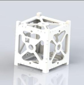

Step 1:
🖨️ 3D Printed Structure
The CubeSat body was designed in **Fusion 360** and printed using PLA on a standard 3D printer. The design follows the 10x10x10 cm
CubeSat body
https://grabcad.com/library/educational-cubesat-1u-1/details?folder_id=6899575
Ground Station body
https://www.thingiverse.com/thing:1159729

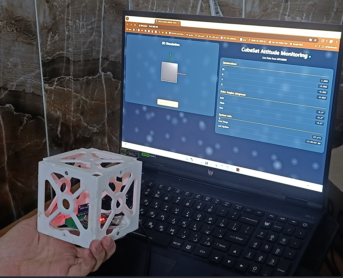

Step 4: 💻 Code Overview
🛰️ Arduino Nano (Satellite Code)
* Reads sensor data from MPU6050 and BME280
* Sends the data over NRF24L01
🌍 ESP32 (Ground Station Code)
* Receives data using NRF24L01
* Displays values on a 20x4 LCD in real-time
📎 All code files are attached at the bottom!
Step 5: 📡 How It Works
1. The satellite unit collects environmental and motion data.
2. The data is sent wirelessly using NRF24L01 to the ground station.
3. The ESP32 receives the data and displays it live on an LCD screen.
4. Optional: You can expand this project to send data to the cloud using ESP32 WiFi!
