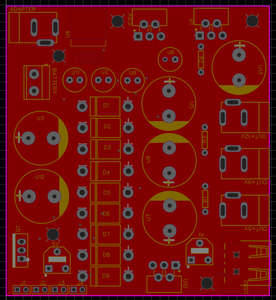

Step 5: πŸ› οΈ Building the UPS (Step-by-Step)

Step 5.1 β€” Install the DC Input Socket
This is your Main 12V Adapter Input.
Label it: 12V IN.
Step 5.2 β€” Connect the IRF9540 MOSFET
Source β†’ Adapter 12V
Drain β†’ Output to Routers
Gate β†’ Battery + through resistor
1N5822 β†’ Across MOSFET for reverse current protection
The MOSFET ensures seamless switching.
Step 5.3 β€” Add the Battery Terminal
Use 2-pin screw terminal:
  1. Pin-1 β†’ Battery +
  2. Pin-2 β†’ Battery –
Connect battery negative directly to all module grounds.
Step 5.4 β€” Install the 220Β΅F Capacitor
Place it across:
+12V line β†’ 220uF β†’ GND
This reduces voltage drop during fast switching.
Step 5.5 β€” Add LM2596 Buck Converter (9V Output)
  1. Connect VIN+ to MOSFET output
  2. Connect VIN– to Ground
  3. Adjust output using 103 preset
  4. Set to exactly 9.0V
Label output: 9V OUT
Step 5.6 β€” Add Second LM2596 (5V Output)
Repeat the same:
  1. VIN+ β†’ MOSFET output
  2. VIN– β†’ Ground
  3. Adjust to 5.0V
Label output: 5V OUT
Step 5.7 β€” Optional: Add XL6009 Boost Converter
If you want:
  1. A stable 12V even when battery drops
  2. A long backup
Connect:
  1. XL6009 VIN β†’ Battery/UPS output
  2. Adjust output to 12V fixed
Step 5.8 β€” Add 1N5822 Schottky Diode
Connect in series with battery or DC adapter depending on your design.
This prevents:
  1. Reverse current
  2. Over-voltage
  3. Sudden spike damage

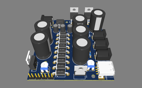

Step 5.9 β€” Final Output Sockets
Add 3 DC sockets:
  1. 12V OUT
  2. 9V OUT
  3. 5V OUT
All from MOSFET-controlled output.
Step 5.10 β€” Final Wiring Check
Before powering:
  1. Check MOSFET orientation
  2. Check 1N5822 direction
  3. Verify LM2596 outputs using multimeter
  4. Ensure no short circuits
