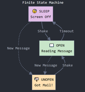

Let's start with the firmware. To tackle this problem, we should break it down to the fundamental behavior: this is a Wi-Fi-connected box that receives text messages and displays them on a screen. When you get a new message, you shake the box and it is revealed!
The best way to model this behavior is with something called a "Finite State Machine" or a Markov Chain. I've included an image of the box's FSM above. Here's how it works:
The message box operates in exactly three states and moves between them based on user actions:
1. SLEEP State
  1. Screen is off to save power
  2. Waiting quietly for user interaction
  3. How to exit: Shake the box → goes to OPEN state
2. UNOPEN State
  1. Shows "You've Got Mail!" notification
  2. Displays mail emoji and "Shake to read" instruction
3. OPEN State
  1. Displays the actual message content
  2. Shows timestamp and scrolls long messages
  3. How to exit: Wait 15 seconds with no activity → goes to SLEEP state
Now that we have a simple FSM behavior decided, we can easily turn that into psuedocode. I've also provided a flowchart above that you can visually understand how our program works.

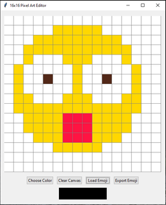

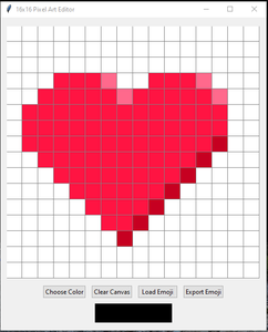

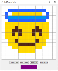

It's important to mention the other files besides the main MessageBox Arduino program. The display library did not include emojis, but I wanted to add emoji support because it's important for conveying feeling, so it was easiest to put these into their own header files. Each of these emoji are accessed by using string codes in your messages. The included emojis are currently limited, but I encourage you to make your own. Here's a complete list of the emoji codes:
😊 Face Emojis
  1. 🙂 Smile → :)
  2. 🙁 Sad → :(
  3. 😉 Wink → ;)
  4. 😍 Heart Eyes → :D
  5. 😂 Laughing with Tears → XD
  6. 😇 Angel → 0)
  7. 😎 Cool (Sunglasses) → B)
  8. 😭 Crying → :=(
  9. 😓 Downcast with Sweat → :'(
  10. 😘 Winky Kiss → ;S
  11. 😏 Smirk → ;P
  12. 😨 Surprised→ :O
💝 Icons & Objects
  1. ❤️ Heart → <3
  2. ⭐ Star → *
  3. 💌 Mail/Love Letter → @
  4. 🐞 Ladybug → LB

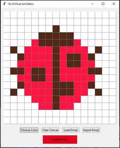

I had to draw each of these emojis by hand, but (with the help of Claude) I developed a Python tool to help me do it! I've also included that here for your use. This step definitely took the most amount of time, and I had to be careful since my girlfriend's plane was boarding in a few hours. I picked our most commonly used emoji's via text, and I made a special one based on my nickname for her: Ladybug.

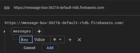

Step 8: The Code: Web Interface and Firebase Setup
For the web interface, I created a simple static HTML page that sends messages to Firebase. Instructables doesn't support HTML file uploads, but you can find the files for this on the project's GitHub repository. I made a couple versions. One plain and one sappy :3
We also need to setup Firebase to be able to store all of the messages and update both ends. To do this, we'll start by making a new Project, create a Real-time Database, and start it in Test Mode. Then, you'll want to add the JSON structure. You can do this by clicking the "+" icon on the database, and adding fields. First, add an empty field called "messages" (Key = "messages", Value = nothing). This will let you add things underneath it. Match the structure exactly as I have in the screenshots above. Don't worry about adding content/messages/dates, that will all be filled in by the box and web interface.
Once that's configured, update the API link in your Message Box Sender UI, and try sending a message! Does it update? Great!
(Also, don't forget to update your Arduino program with this new API endpoint!)
