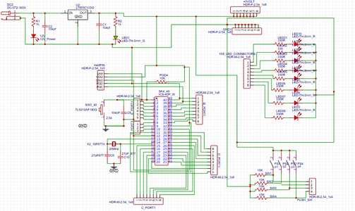

Step 1: πŸ’» Circuit Diagram Explanation
Discover Easy, Affordable, and Reliable PCB manufacturing with JLCPCB!Register to get $70 New customer coupons:https://jlcpcb.com/?from=EST
Special Deal: Get a $30 coupon for JLCPCB premium 6-layer PCBs: https://jlcpcb.com/6-layer-pcb?from=getcoupon
The circuit diagram (shown above) illustrates how the PIC16F877A communicates with the Bluetooth module and controls four relays through its PORTB pins.
  1. Bluetooth Communication:
  2. The Bluetooth module is connected to the microcontroller via RC6 (TX) and RC7 (RX) pins for UART communication.
  3. Relay Control:
  4. Relays are connected to pins RB0, RB1, RB2, and RB3 using transistors as drivers. Each relay operates an LED indicator for visual feedback.
  5. Power Supply:
  6. The circuit uses a 7805 voltage regulator to step down and stabilize the 5V supply for both the microcontroller and Bluetooth module.

Step 4: 🧩 PCB Design Overview
The PCB layout, designed in Proteus ARES, integrates all components neatly on a single board.
Features of the PCB Design:
  1. Four relay control circuits with flyback diodes
  2. On-board Bluetooth interface
  3. 7805 regulator power supply section
  4. LED status indicators
  5. 12V DC input with polarity protection
  6. Clearly labeled connectors and ports
This compact PCB ensures durability, professional look, and ease of assembly for IoT and automation projects.
