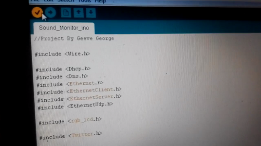

Step 2: Software Setup!
Firstly you need to setup WIFI on your Edison Board to do so visit :
https://communities.intel.com/docs/DOC-23147
After setting up WiFi you need to download the following libraries :
1) Twitter Libraries from : http://arduino-tweet.appspot.com/ ( Also the Twitter Token key is to be noted! )
2) Wifi library ( Present in the Arduino IDE by Default )
3) SPI library ( Present in the Arduino IDE by Default )
4) RGB LCD Display Library
*To install the LCD Display libraries , download a zip file from here .
Extract the contents of the zip file to the arduino IDE folder. Open the extracted folder and go into the libraries folder and copy Grove_LCD_RGB_Backlight to Arduino libraries folder.
After that open the arduino ide and go to sketch>import libraries>add libraries and select the folder containing the LCD Display libraries and click open.Again go to sketch> import libraries and select the LCD Library.
Now its time to code!
Download the attached ino file here :
https://www.instructables.com/files/orig/FAC/BVHU/I4WYSE0I/FACBVHUI4WYSE0I.ino
Come on guys reverse engineer the code and make amazing stuff for a better world , a better tomorrow!

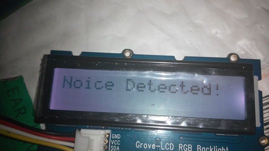

In this project we will be converting String to Char .
I made use of LCD Displays in this project to notify the user that the tweet is going to be made , we will see how to code simple LCD Animation and finally tweet out the warnings when loud sounds are produced at your home!
Best of luck , keep making! Now its time for the tests and results!
Step 3: Tests and Result!
After all the coding here is the final result!
