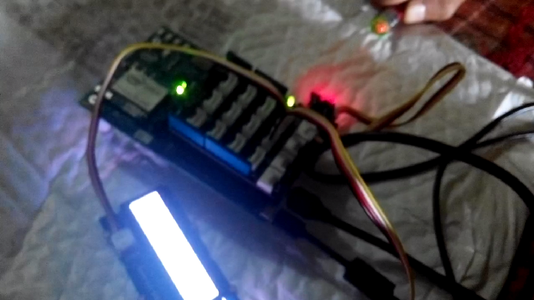

Step 1: Hardware Setup!
Thanks again to Intel , Audrey and Instructables for the Grove IoT Developers Kit , some of the components of this kit is required for this home automation project. :)
Materials Required :
- An Intel Edison Board connected to the Arduino Extension Board or an Intel Galileo Board.
-Grove Light Sensor
-Grove Buzzer
-Grove LCD RGB Backlight Display ( LCD Display , 16*2 )
-Grove Base Shield
-Grove 26AWG Cable Wires
-Laser Pointer ( 5mW ) ( Do not use powerful lasers! )
Steps :
1) -Firstly Connect the USB Cables to the Board!
2) -Then take out the Grove Base Shield and plug it on to the board!
3)-Next take out one 26AWG Grove Cable and connect it to the Grove Light Sensor.
4) -Then connect the Cable to A0 pin in the Base Shield.
5) -Now take out the LCD Display and connect it to the Grove Cable.
6) -Connect the other end of the grove cable to I2C in the Grove Base Sheild!
7) -Now take out the Grove Buzzer and connect it to D8 pin

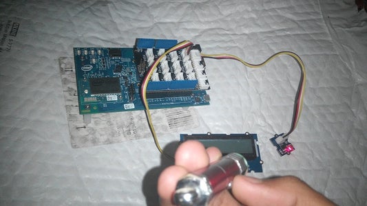

8) Now setup all the Hardware as shown in the First Picture!
9) Setup the Laser and light sensor parallel to each other as shown in the second and third picture!
10) -That's all for the hardware setup!
*Refer the first Picture to see the Hardware Setup also the Video for the connections and a detailed overview!
*Try to setup the Laser and the Light Sensor in such a way that they are parallel to each other as shown in the second and third picture!

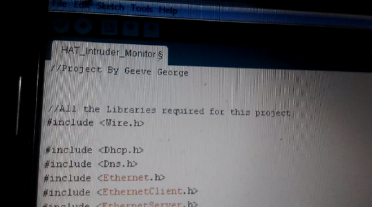

Step 2: Software Setup!
Firstly you need to setup WIFI on your Edison Board to do so visit :
https://communities.intel.com/docs/DOC-23147
After setting up WiFi you need to download the following libraries :
1) Twitter Libraries from : http://arduino-tweet.appspot.com/ ( Also the Twitter Token key is to be noted! )
2) Wifi library ( Present in the Arduino IDE by Default )
3) SPI library ( Present in the Arduino IDE by Default )
4) RGB LCD Display Library
*To install the LCD Display libraries , download a zip file from here .
Extract the contents of the zip file to the arduino IDE folder.
Open the extracted folder and go into the libraries folder and copy Grove_LCD_RGB_Backlight to Arduino libraries folder.
After that open the arduino ide and go to sketch>import libraries>add libraries and select the folder containing the LCD Display libraries and click open.Again go to sketch> import libraries and select the LCD Library.
Now its time to code!
Download the attached ino file here :
Come on guys reverse engineer the code and make amazing stuff for a better world , a better tomorrow!

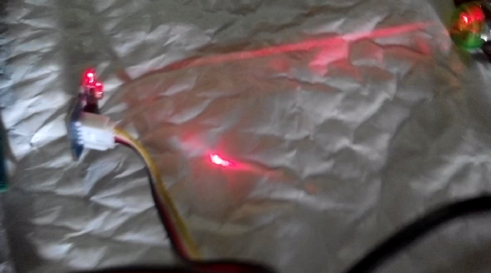

How does this project work?
As you can see in the video below, in this project we used buzzers , light sensors , LCD Displays and lasers!!
The code for this project was challenging and interesting for me to work on.
In this project we will be using light sensors , lcd display, lasers, buzzers and the Twitter API to detect when an intruder enters your home , while you are away from your home!
Intruders wont be able to notice a 5mW Laser as it wont show the path of light unless exposed to a dense environment!
When the intruder enters the room were your valuables are placed the buzzer turns on and a tweet is sent to your twitter account , thus you can see the tweet from your office or anywhere you are and take immediate action by notifying the neighbors or take an action yourself!
I came up with the innovation to use Light sensors in my Home Automation Tweeter series of projects as photoresistors are very cheap and efficient!. In this project we will be converting String to Char .
I made use of LCD Displays in this project to notify the user that the tweet is going to be made , we will see how to code simple LCD Animation and finally tweet out the warnings when an intruder enters your home!
