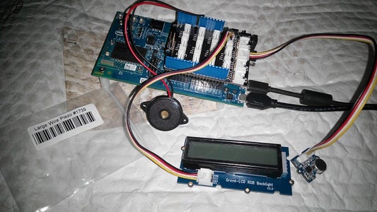

Materials Required :
- An Intel Edison Board connected to the Arduino Extension Board or an Intel Galileo Board.
- Piezo Element ( Buy it from ADAFRUIT )
-Grove LCD RGB Backlight Display ( LCD Display , 16*2 ) ( Optional )
-Grove Base Shield
-Grove 26AWG Cable Wires
Steps :
1) -Firstly Connect the USB Cables to the Board!
2) -Then take out the Grove Base Shield and plug it on to the board!
3) -Now take out the LCD Display and connect it to the Grove Cable.
4) -Connect the other end of the grove cable to I2C in the Grove Base Sheild!
5) -Now take out the Piezo Element and connect the red wire to the A0 ( Analog Pin 0 ) of the base sheild!
6) -Next connect the 26AEG Wire to the Sound sensor.
7)-Connect the sound sensor to A1 ( Analog Pin 1 )
8) -That's all for the hardware setup!
*Refer the Picture to see the Hardware Setup also the Video for the connections and a detailed overview!

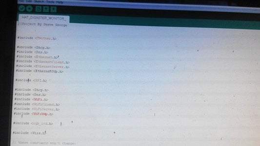

Step 2: Software Setup!
Firstly you need to setup WIFI on your Edison Board to do so visit :
https://communities.intel.com/docs/DOC-23147
After setting up WiFi you need to download the following libraries :
1) Twitter Libraries from : http://arduino-tweet.appspot.com/ ( Also the Twitter Token key is to be noted! )
2) Wifi library ( Present in the Arduino IDE by Default )
3) SPI library ( Present in the Arduino IDE by Default )
4) RGB LCD Display Library ( Click here to download )
*To install the LCD Display libraries , download a zip file from here
Extract the contents of the zip file to the arduino IDE folder.
Open the extracted folder and go into the libraries folder and copy Grove_LCD_RGB_Backlight to Arduino libraries folder. After that open the arduino ide and go to sketch>import libraries>add libraries and select the folder containing the LCD Display libraries and click open.
Again go to sketch> import libraries and select the LCD Library.
Now its time to code!
The Code is attached ! ( .ino File )
Come on guys reverse engineer the code and make amazing stuff for a better world , a better tomorrow!
