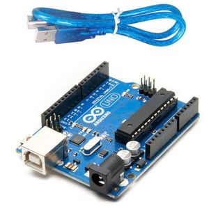

  1. Arduino Uno (or compatible) x1

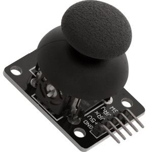

  2. Joystick module x1

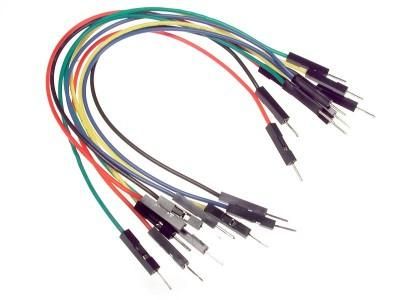

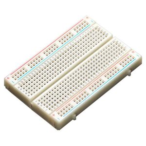

  7. Breadboard & jumper wires (as needed)
I started with Arduino Complete Starter KIT Uno R3 by Elegoo, has all that is needed +more to get you started on new ideas!

Joystick:
  1. X-axis (VRx) → A1
  2. Y-axis (VRy) → A2
  3. SW (button) → D7
  4. VCC/GND → 5V/GND
