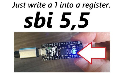

Step 3: ⚡ Try It Yourself in 30 Seconds!
  1. Open 👉 https://costycnc.github.io/avr-compiler-js/
  2. Plug in your Arduino via USB
  3. Upload this code:
sbi(5, 5); // LED ON
  1. LED turns on! Now try:
cbi(5, 5); // LED OFF
Boom – the LED is off. You just spoke directly to the silicon.
