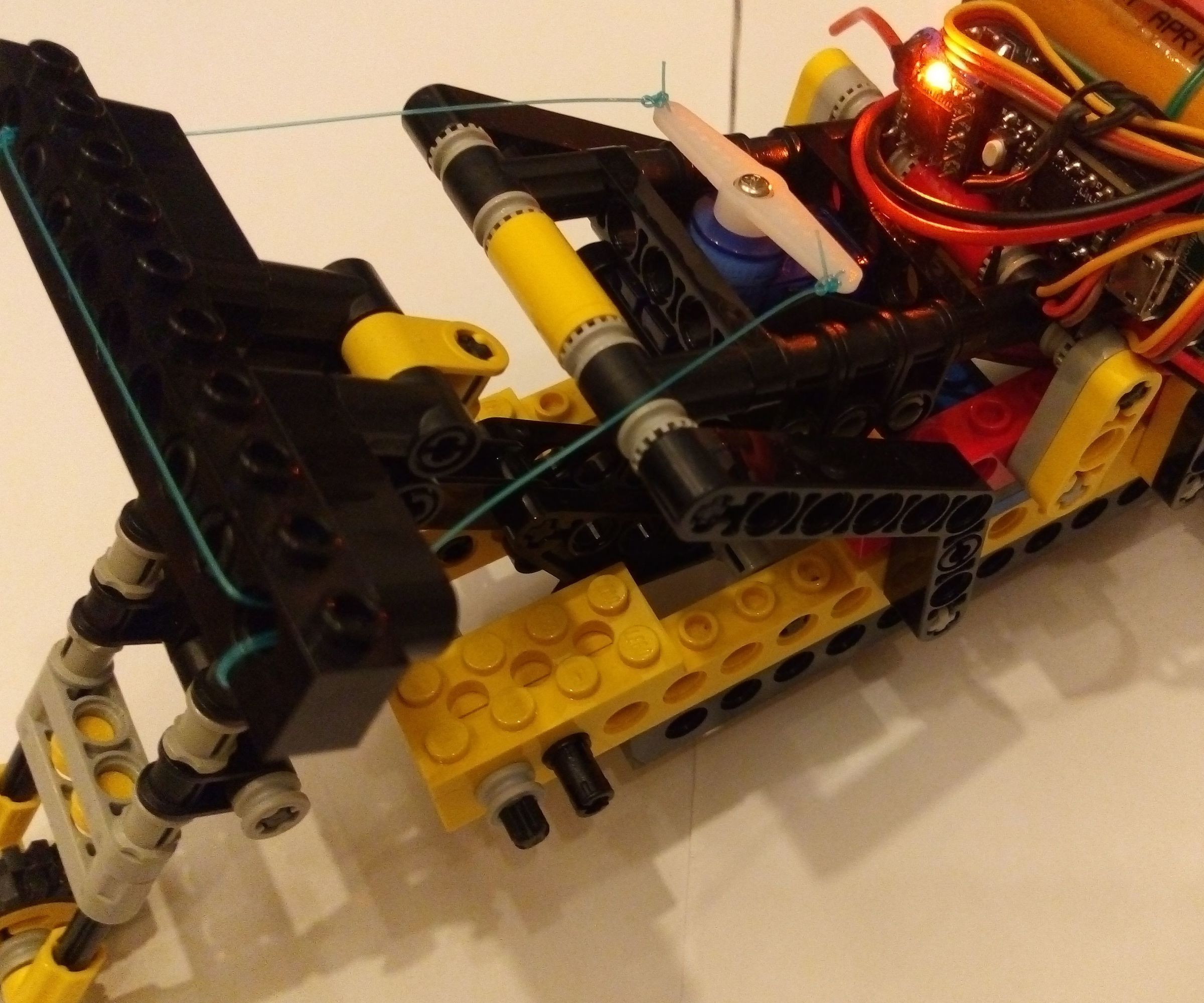

Since I wanted to drive at least 2 motors and 2 servos, I made a small PCB which implemented the described circuitry and that you can see on the picture. However, the first prototype was made on a proto-board using flying wires.
Thus, you don’t need any soldering/PCB design skills to implement this simple project :)

In my case I connected the incoming value directly to the motor and servo, but you are more than welcome to change it accordingly to your needs! In the video and pictures linked in this tutorial I connected 2 motors and 2 servos, but there could be 3, 4, 5,...up to the maximum available free pins (13 in case of uChip).
