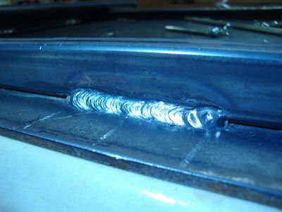

cut the frame members, arrange, clamp, tack, check, weld out.
clamp frame to top plate, tack, check, weld out. i guessed at the weldments, but did put some thought into them. first time ever welding square tube to plate, and worth its imperfection. learned the heat must be turned up pretty high to really get the arc down into the gap to fully butter in top and bottom. not very good all together, but some were damn fine, i'd say. 1/8" 7018 at around 150 amps seemed to do it. i did not weld the joints on the face to mate with the top plate, so i wouldn't have to grind those joints flat. this thing is solid, and yet only 62 pounds. before boring about (80) 1/2" holes in it. the half inch plate i use currently for welding weighs over one hundred all by itself. inconvenient. plus, i just plunk it down on top of a workmate type workstand. meanwhile, i set the new top across two heavy saw horses and stood on it. felt like i was on stage, it was just that solid. measure, mark, and drill holes on grid pattern. the pattern i chose was not precisely square. 3" centers along the short side, more like 3.75" along the long side. this was to make the spacing even, whilst not boring through the frame. after drilling, it weighs about 60 pounds.

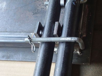

the top attaches to the base with brackets made of scrap 1/4" plate, cut, drilled and dressed.
(8) 1" x 1.25" pieces
on four pieces, 5/16" hole drilled centered on the short axis, 0.75" from the end to be welded to the top frame
assemble the base, including the brackets. tack the brackets in place. check and recheck the fit by removing and replacing the base. get them in the right places, weld out.
weld the bracket pieces with holes outboard from the legs they support. the pieces with no holes, place inboard. when all in place, drill through outer bracket and leg into inner bracket. this is to ensure alignment. this part proved tough to complete. biggest lesson from the entire project... accurate drilling in steel is more difficult than it sounds. thus i decided the regular grid pattern could not be completed with the precision i wanted. a healthy complement of locking c-clamps will have to do. i believe they will. anyway, with luck and a little reaming, the holes will align.
cut (6) 5/16" round pins, (4) at 5", (2) at 4". the five inch pieces pin the legs to the base. the four inch pieces pin the legs together at their pivot points. drill 7/64" (or there abouts) holes into the pins, near the ends, to accept the 3/32" hitch pins. assemble them temp-like, mark the finished length needed, then put them in a vise and pound away to ninety degrees. clearly there are more elegant ways to do this, but whatever.
in the future, i may return to drill the legs all through where they align with the brackets when folded up, as illustrated.
