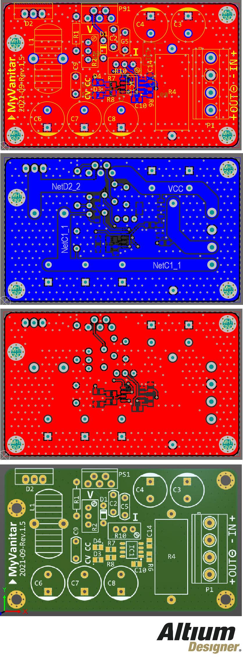

B. PCB Layout Figure 2 shows the PCB layout of the variable switching power supply board. It is a two layers PCB board and a mixture of SMD and through-hole components have been used to make it as compact as possible.
Step 3: Figure 2 PCB Layout of the Adjustable Switching Power Supply

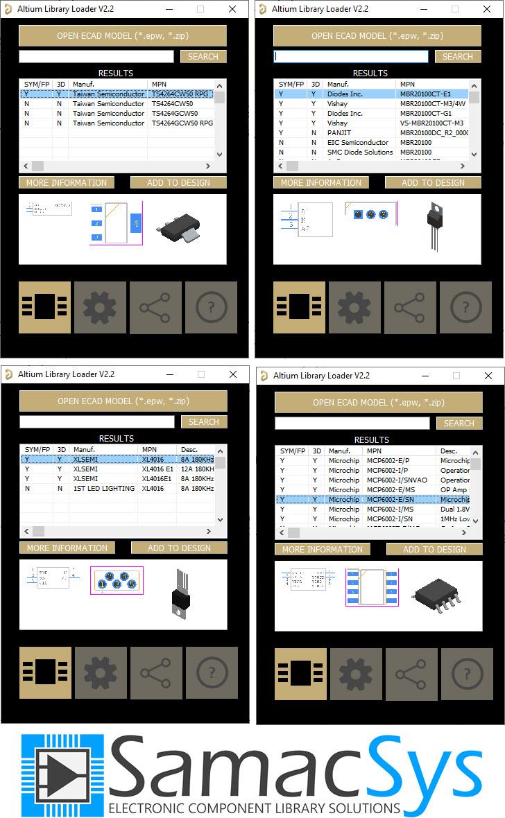

I used the Altium Designer software [5] to design the schematic and PCB. I did not have the schematic symbols, PCB footprints, and 3D models of several components in this project. So instead of wasting my time in designing the component libraries from scratch and increase the risk of errors and mismatches, I used the free and IPC-rated SamacSys component libraries and imported them right into the Altium PCB project using the SamacSys Altium plugin [6]. SamacSys provides plugins for the majority of electronic designing CAD software [7], not just for the Altium Designer. Figure 3 shows the supported electronic designing CAD software.
Step 4: Figure 3 SamacSys Supported Electronic Designing CAD Software (plugins)
Specifically, I used the SamacSys libraries for PS1[8], IC1[9], IC2 [10], and D2[11] which you can consider in the references. Another option is to download the component libraries from componentsearchengine.com and import them manually. Figure 4 shows the selected components in the SamacSys Altium plugin.
Step 5: Figure 4 Selected Components in the SamacSys Altium Plugin

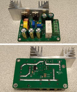

C. Assembly and Test
Figure 5 shows the assembled board from the top and bottom view. As it is clear that both sides of the PCB have been used to mount the components. As you see high-current carrying tracks are partially covered by the solder mask. You must strengthen these tracks using solder and/or copper wires (tinning).
Step 6: Figure 5 Assembled PCB Board (top and Bottom View)

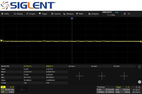

C-1. Output Noise
I used the power analysis feature of the Siglent SDS2102X Plus oscilloscope [12] to measure the output noise. Surely you can use the cheaper Siglent SDS1104X-E oscilloscope [13] and replicate the experiment without any problem, however, the plus one is a role model device.

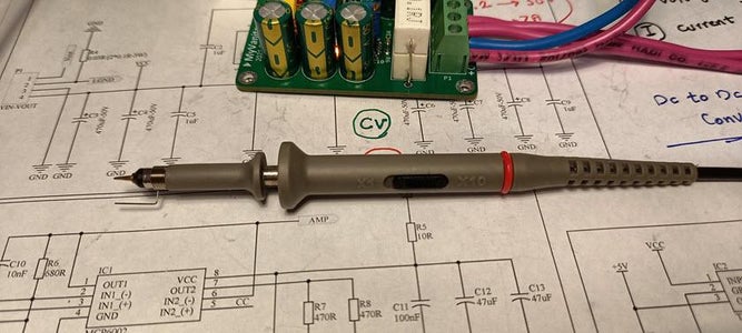

The first test is to check the output noise of the power supply under no load. For this purpose, I should remove the ground lead of the oscilloscope probe, remove the probe’s head, and place a ground spring on the head (figure 6). Also, enable the 20MHz bandwidth limit of the input channel and put the probe on X10.
Step 7: Figure 6 Preparing the Oscilloscope Probe to Measure the Power Supply Noise
Then put the probe tip directly on the output of the power supply. Figure 7 shows the output noise of the power supply under no load.
Step 8: Figure 7 the Output Noise of the Adjustable Switching Power Supply (no Load, 20MHz BW Limit)

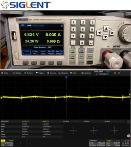

The best choice to build stable and accurate DC loads, is a commercial DC load, such as the Siglent SDL1020X-E [14]. This device guarantees the stability and accuracy of the load in a variety of modes, such as CC, CV, CP, CR .. etc. The CC mode of the SDL1020X-E model is limited to 5A, so let’s test the output noise under a 5A load for now. Figure 8 shows the output noise of the power supply under a 5A load. You can consider the screens of the DC load and the oscilloscope.
Step 9: Figure 8 the Output Noise of the Adjustable Switching Power Supply (5A Load, CC Mode, 20MHz BW Limit)

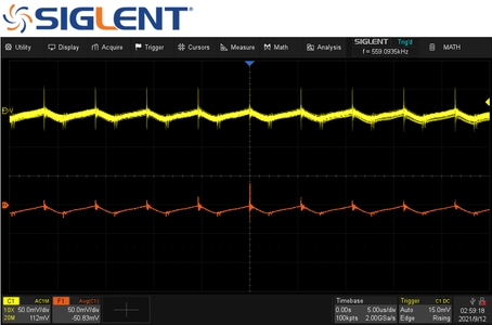

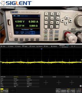

To test the output noise under a 6A load (max continuous), I set the DC load on CR (constat resistance) and changed the value of the resistor to read 6A at the output of the power supply. Figure 9 shows the output noise under a 6A load.
Step 10: Figure 9 the Output of the Adjustable Switching Power Supply (6A Load, CR Mode, 20MHz BW Limit)
Figure 10 shows the output noise of the power supply (6A load), after applying the 16 points averaging using the math function (brown waveform).
Step 11: Figure 10 the Output Noise of the Adjustable Switching Power Supply (6A Load, CR Mode, 20MHz BW Limit, 16P Averaging)

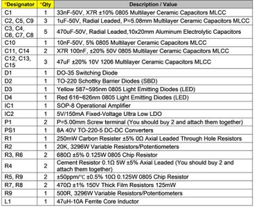

Figure 11 shows the bill of materials for the projects. Please consider that I have not included the L1 and the heatsink in the bill of materials for the assembly. Make sure that your selected/built inductor (ferrite core) can tolerate at least 10A (47uH). The hole diameter of the inductor’s pads is 1.3mm.
Step 12: Figure 11 the Bill of Materials of the Adjustable Switching Power Supply
