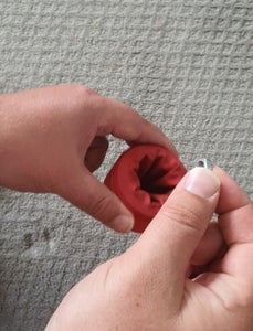

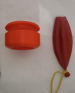

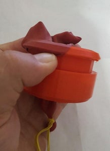

Step 2: Balloon Prep
- get your punch balloon
- measure 5 inches from tight off section
- cut along the dotted line as shown in the image

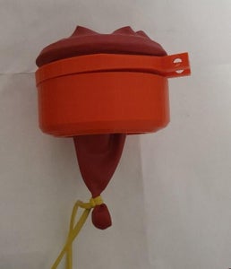

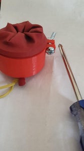

Step 3: Assembly
- get your main body of the sling and cut punch balloon

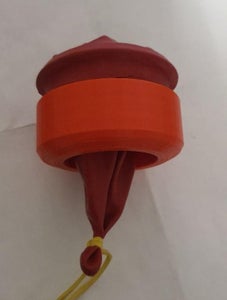

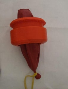

- insert balloon thru big hole of the main body of the slingshot
- stretch balloon section where you made a cut and pull balloon around the small lip of the main body of the slingshot
- stretchy balloon on to the cut out section where holding ring can securely hold balloon in place

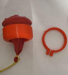

- place holding ring in the cut out section for the main part of the slingshot ( might need to slightly stretch the holding ring)
- align holding ring so it right on top of the balloon
- use 1/4 inch -20x1 inch bolt and wingnut to secure holding ring around the main part of the slingshot
Step 4: Test and Go Shoot!
- After assembling your slingshot make sure you tighten your bolt using philip screwdriver and holding down wing nut until its secured
