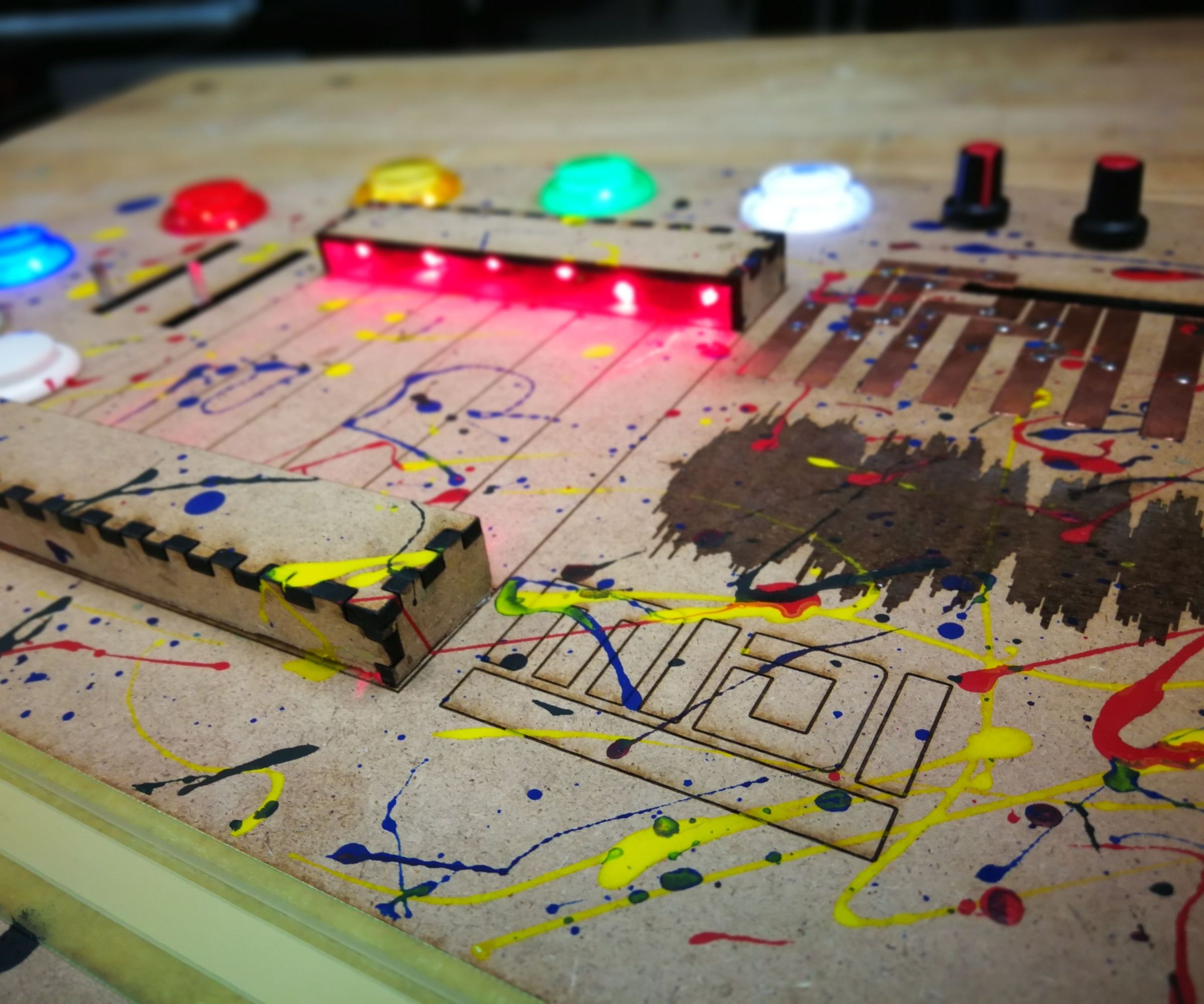

Step 3: Build the Circuit!
If you like pictures and know your way around a breadboard this method might resonate with you. I take you through the steps in the middle part of the video, but I will include some screenshots of the steps here for reference as well.
(1st picture)
Step 1: Connect Red hookup wire from "VCC" pin on Arduino to the "+" rail of the breadboard.
Step 2: Connect Red hookup wire from right-hand pin on potentiometer to the "+" rail on the breadboard.
Step 3: Connect Blue hookup wire from "GND" pin on Arduino to the "-" rail of the breadboard.
Step 4: Connect Blue hookup wire from left-hand pin on potentiometer to the "-" rail on the breadboard.
Step 5: Connect Blue hookup wire from one of the pins on the button to the "-" rail of the breadboard.
(2nd picture)
Step 1: Connect White jumper wire from "the other" pin on the button to pin "2" on the Arduino.
(3rd picture)
Step 1: Connect White Jumper wire from the middle pin on the potentiometer to pin "A0" on the Arduino.
(4th picture)
This shows the spacing and pin alignment of the potentiometer.
