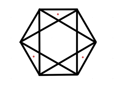

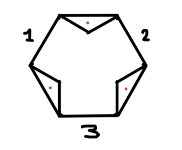

Step 3: Make the Main Body
To attach the legs and the hinges, glue on 1cm long and 2cm tall pieces of PVC onto the hexagon. Draw lines connecting opposite vertices of the polygon. You will notice that small triangles appear on the side: three of them. Glue the small pieces on, referring to the image above. Cut out a triangle to fit in-between the 6 pieces, and glue that on as well.
