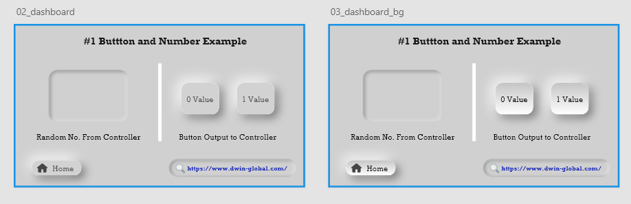

Step 1: Design Your UI With XD or Other Software
Design your desired application UI using photoshop, Adobe XD or any image editing software. Select the proper image resolution size of all images as per the resolution of the screen. Design both front and back UI means whenever we click on any item on screen how the effect should look so it will give us the touch effect. As shown in the image below.
