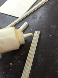

Step 2: Cutting the Plywood:
We'll begin with the half inch, 24X24in piece of plywood. Start by using a band saw to cut 10, 1/4X16in pieces.

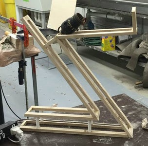

Step 4: Make Connections:
Using wood glue connect the pieces of wood so that they look like they are creating a 45 degree angle. It is important that you either clamp or hold the pieces of wood together for at least 30 minutes to allow the glue to set.
Step 5: Connect the Frame:
Once the frames are formed connect them together with a 6/8th of an inch long piece of the plywood. Again using woodglue and clamping for at least 30 minutes for proper setting to occur.

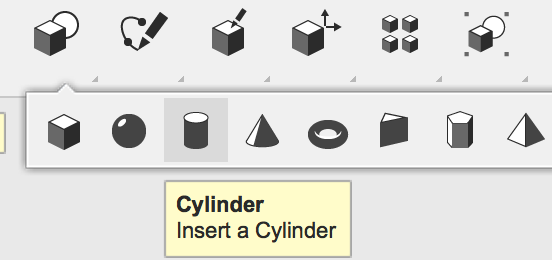

Step 11: 3D Printing: Making the Cylinder
Designing the cylinder is quite easy. Within 123D Design there is a top bar with many different options of ways to design. We're interesting in the "primitives" option which allows the user to select multiple different forms to start a design. Click on the primitives icon and select "Cylinder."

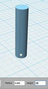

Step 12: 3D Printing: Sizing the Cylinder
After you click on the "Cylinder" from the "Primitive" button on the top bar you have to put in the radius and height that you want the cylinder to be. Luckily, for you, I have done all the math for you already. In order for the cylinder to fit nicely inside our base the radius must be 4.445mm and the height must be 8.89mm (millimeters). Now export you file into an .stl this is the only file the printer will be able to understand.

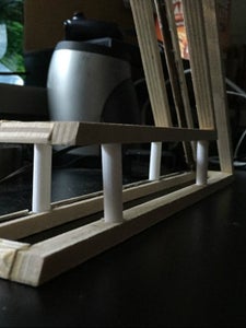

Step 21: Drill
Now, it's time to put our cylinder prints in the stand. Using a 3/8in drill and a drill press carefully, without going all the way through the piece of wood drill into it about half way down. These crevices is where we will set the cylinders. The holes need to be equal distances in length, and equal distances in width away from each other. The first holes need to be 2 inches from the of the wood and centered. The next two holes 6 inches away from the first two holes. Now, simply match the bottom four holes with the "top" part of the stand and mark the wood. Drill the last four holes on the top piece. Put a small amount of hot glue on both ends of the cylinders and place them vertically in the drilled holes and set for a few minutes.
Step 22: Support: Cut
Now we have to cut some more wood! The pieces that we are creating now are just to give the structure more support for the weight of the bulb and shade. So, cut two (in the same dimensions as before just changing the length) 7 and 3/4ths inch pieces which will be used to hold the bulb. Two, two inch pieces to support the shade, and two 1 and a half inch pieces to support the two front angled pieces of the stand. Finally an inch piece to connect the 2 inch pieces.
Step 23: Support: Construct
Now that you have your pieces, using the same gluing techniques mentioned before glue the two 7 and 3/4th inch pieces to the front angles pieces of the stand. Glue the two, two inch pieces on top of the 7 and 3/4th inch pieces at the very end of them. And finally, at 45 degree angle glue the remaining 1 and half pieces in between the front two angled pieces and the back two angled pieces.

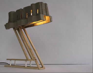

Step 24: Shade
Any shade can really be used with this stand. I found this piece of recycled cardboard which works as the shade however anything can be used. The only adjustment I made to the shade was cutting into the shade to made vertical lines for the light to come out in a interesting way. Also I just glued in pieces of wood inside the shade for a place the support pieces could rest on to prevent the shade from going too far down. This adding of the wood inside could be used with any object that you want to be turned into a shade.
