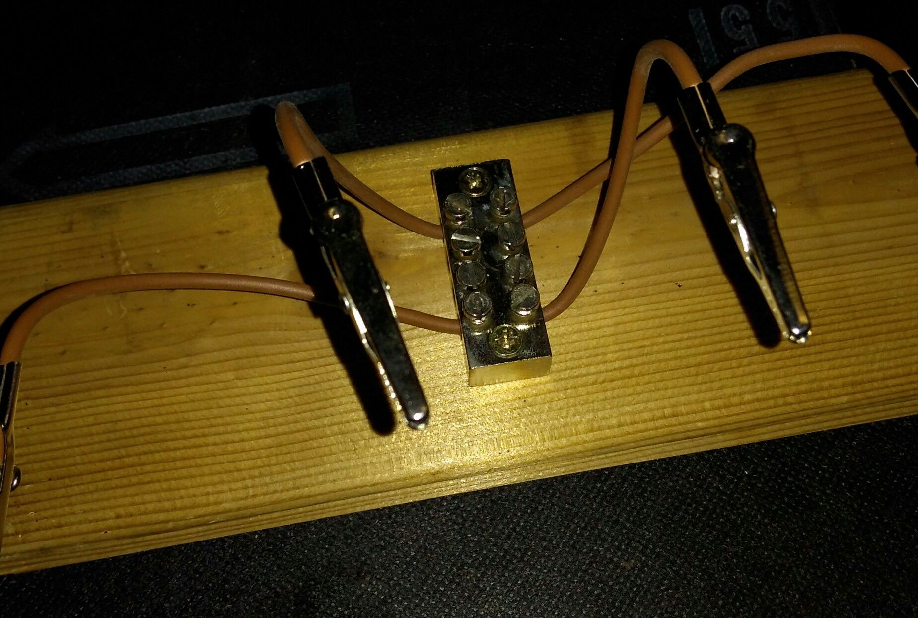

Step 3: Wiring the Speakers
Here I used a piece of Veroboard to connect the speaker wire to a 3.5mm jack lead. The speakers I bought came with 6 wires. The yellow and black turned out to be a pass through connection for the CMOS battery in the donor laptop, so can be ignored. The other wires follow normal colour convention i.e. red is right, white is left and the blacks are negatives.
