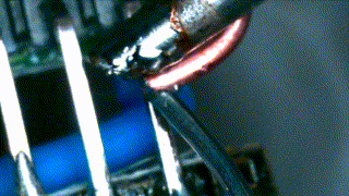

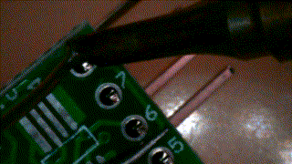

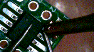

Step 1: Install the Microcontroller to the Breakout PCB
First, fix two opposite corner pins. Apply some soldering flux and solder the remaining pins. Use copper wick with flux if you need to remove unwanted solder.

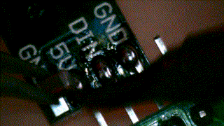

Step 4: Attach WS2812 LED Stick
The LED module has pads on the both sides. Make sure you use the DIN side. I also installed two capacitors (10uF and 100nF) between VSS and VDD. They are needed for MCU, not for LEDs. So you might want to install them closer to the MCU power pins.

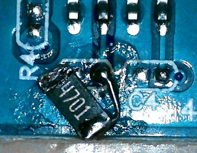

Step 6: Tuning TP4056 Charging Controller (optionally)
The charging current is determined by the R3 resistor. Typically, the default resistor is set for the maximum current, which could potentially damage your battery. If your board is becoming hot during charging, you may consider replacing the resistor. The typical values are in the table below.
R3 (kOhm) I_BAT (mA)
10 130
5 250
4 300
3 400
2 580
1.66 690
1.5 780
1.33 900
1.2 1000

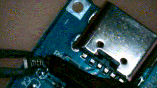

Connect the TP4056 output leads to the power inputs of the microcontroller using thick wires.

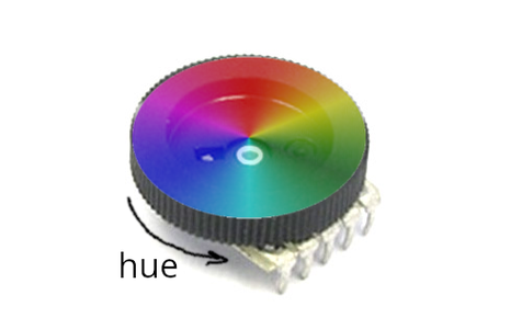

Step 10: Understanding Animation and Color Transformation
I wanted to provide a natural color picking interface, so I used a thumbwheel potentiometer, which resembles HSV color model cylinder. The plot depicts the idea of HSV to RGB transformation. it is implemented in setHue() function. The user could only change hue, while everything else is controlled by fireAnimation() routine.
Each pixel holds its own heat value. As the animation unfolds, pixels experience random cooldowns, with only the three bottom pixels occasionally receiving random bursts of heat. Following the laws of thermodynamics, heat gracefully flows and evens out among neighboring pixels. This simple model creates the illusion of fire.
