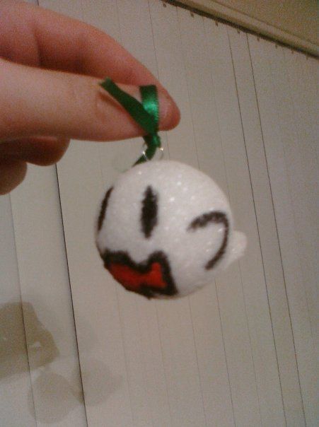

My friend (fuzzwuzzle.com) was inspired by this instructable and made the attached. I love 'em!
Reply 11 years ago on Introduction
Boo looks so much less scary when he is an ornament XD
