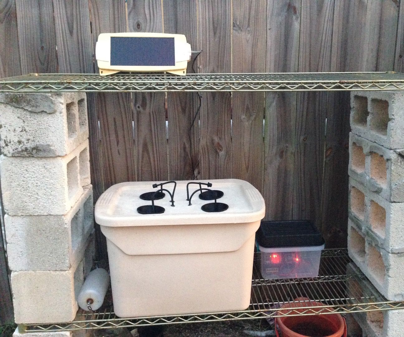

As I said I jammed mine in another rapid rooter plug and squeezed it gently next to the one with the plant in it, then covered in with lava rock.
