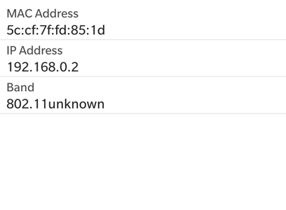

Step 3: Enter the Device's IP Address in Any Browser
If you're using your phone as an access point, go to the device details, look at the IP address and enter it in any browser. After you've entered the device's IP address, you'll see the web interface.

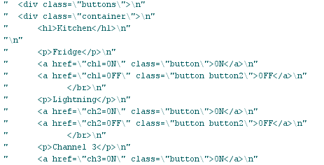

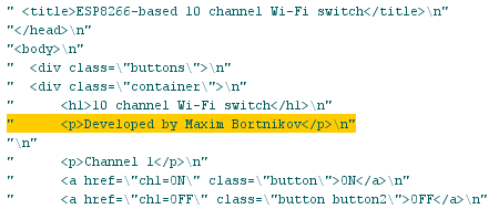

Step 4: Customize the Web Interface
Delete the highlighted string and change: 10 channel Wi-Fi switch; Channel1; Channel2; etc. For whatever you want. An example of a customized web interface is in the second screen.
Don't forget to flash ESP.
Step 5: Check the Customized Web Interface
It should look like this. You can also play with colors or completely redesign the whole thing. It's up to you.

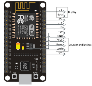

Step 6: Schematic Diagram (CD4024B As a Counter)
Finally, it's time to put all of the components together.
Step 7: Schematic Diagram (CD4020B and SN74LS93 As Counters)
I picked this one.
