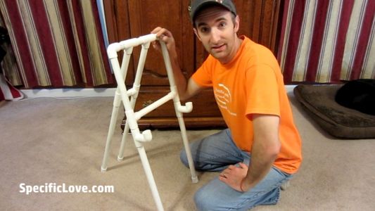

Step 6: Life Hack 6: Easel for Kids
Easel for Kids
Need:
- 3/4-inch PVC pipe
- (8) T-connectors
- (4) Elbows
- (4) End caps
If you have a child who loves to paint, here is an easy project for you.
I created this simple Easel for kids.
I am using all 3/4 inch PVC pipe and fittings to give this project a little more strength.
The length of the pipes can vary a little depending on the size you want to make it.
I first started with the top. I have and elbow on each side and 2 T-connectors in the middle.
The elbows are for the front section and the T’s are for the rear legs.
The rear legs need to have a support bar connected with T’s somewhere in the middle.
This gives the legs strength and stability.
On the front section, I added a support bar to add strength, but I also added a second set of T-connectors just below the support bar.
The second set of connectors is faced forward and an elbow is attached to each one.
The elbows are support holders for the canvas.
The important thing to remember is that the front length needs to be about 2 inches shorter that the rear length.
By having the different sizes, will allow the front section to stand straighter than the rear section when in use.
This easel can be folded together so it can slide under a bed or put away in a closet.
Have fun painting.

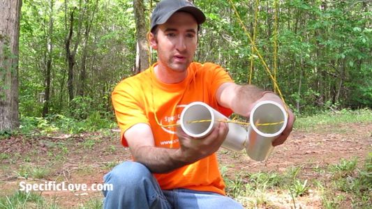

Step 8: Life Hack 8: Tree Swing
Tree Swing
Need:
- (2) 3-inch PVC pipe (18 inches long)
- Heavy duty rope
- Place to hang it
Tools:
- Drill
If you have ever wanted a tree swing, here is a simple technique to make one.
I took two sections of 3-inch PVC pipe that were cut to 18-inches in length.
I then took a drill and made a hole about 2 inches inward on both ends. The holes need to be all of the way through the pipe.
I next used some paracord to string up the pipe, but I strongly suggest you use some thicker and more durable rope to hang these pipes.
The rope goes through both pipes touching side-by-side.
By using two pipes, allows the seat to be a little flexible by twisting when needed.
This design is surprising comfortable.
