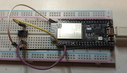

Step 1: Watchdog: PIC10F200 (a Small Microcontroller)
This uses a single PIC10F200 8pin DIL-Chip, and does not normally require any additional components.
It is connected to 3.3V power (drawing about 250uA), Ground, the ESP32-reset-pin, and a single ESP32-GPIO to provide the "feed-watchdog" signal.
(If the 250uA is too high, then it is probably possible to reduce the curent to ~0.1uA if you redesign the software to SLEEP the PIC10F200.)
Note that if triggered, the PIC10F200 will pull-down the ESP32's reset pin for 2 seconds to reset the ESP32. It is capapble of sinking/sourcing upto 20mA from/to the ESP32's reset-pin.
Most MCUs only need 0.5mA or less sink/source to reset. However, if more than 20mA if needed, you will need to add a NPN-transistor and base-resistor to pull-down the reset pin.
If your MCU does not have a reset pin available, then you will instead need to add a P-type-MOSFET on the ESP32's power supply and use the watchdog to turn that off/on instead.
The code for the PIC10F200 is shown below:

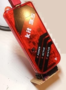

I used the "Microchip MPLAB X IDE v6.20" with the "XC8 (C-compiler)", with a "PicKit 3.5 programmer" (a clone of the Microchip PicKit 3).
The ESP32 needs to toggle the PIC10F200-GPIO-3 once in a while (gaps between 1second and 10minute ) and if not the PIC10F200-GPIO-0 will be pulled down for 2seconds to reset the ESP32.
Note that the ESP32 can tell if it has been reset by the PIC10F200 by reading the PIC10F200-GPIO-3 at boot: a high indicates that the watchdog has triggered.
The Arduino-Test-Code running on the ESP32 (demonstrating watchdog-feeding, watchdog-triggering, and also reading-the-watchdog-triggered-signal) is attached below ("External-PIC10F200-Watchdog-Demo_Sketch.ino"). This demo code gives the following output:

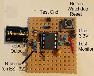

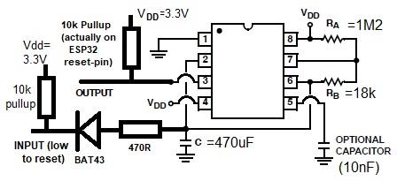

Step 2: Watchdog: Using a 555-Timer-Chip
This uses a "ICM7555" CMOS Timer Chip. The schematic / components are shown above (4x Resistors, 2x Capacotors, 1x Diode) (exc. pullup on output).
It is connected to 3.3V power (drawing about 75uA), Ground, the ESP32-reset-pin, and a single ESP32-GPIO to provide the "feed-watchdog" signal.
Note that if triggered, the 555 will pull-down the ESP32's reset pin for about 6 seconds to reset the ESP32.
It is capapble of sinking/sourcing probably upto about 200mA (dependent on chip) from/to the ESP32's reset-pin.
To "feed-the-watchdog", the ESP32 needs to pulse/pull the "BAT43" terminal to ground for about 1.5s, and then either return it to HIGH or open-circuit (set to INPUT or INPUT_PULLUP).
The if above watchdog-pulse is not sent in under ~10minutes the 555 will time-out and pull it's output down for ~6seconds.
Note that with this circuit the ESP32 can NOT tell if it has been reset by the watchdog or not.
This watchdog is not as good as the PIC10F200 one, because if the ESP32 PULLs(OUTPUT) the BAT43 pin LOW and leaves it there, the 555-Watchdog will never trigger.
[Which is why it's perhaps better to return the GPIO to INPUT Or INPUT_PULLUP (rather than OUPUT-HIGH) in between watchdog-pulses.]
(Note that if the ESP32 is using "pinMode(WATCHDOG_PIN,INPUT)" the above shown external pullup on the INPUT is necessary to ensure the BAT43 remains off as pin-6 charges to ~2.2V)
