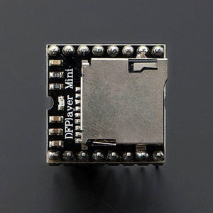

Dfplayer mini MP3 codec, amp & SD card mount - Pi Hut link

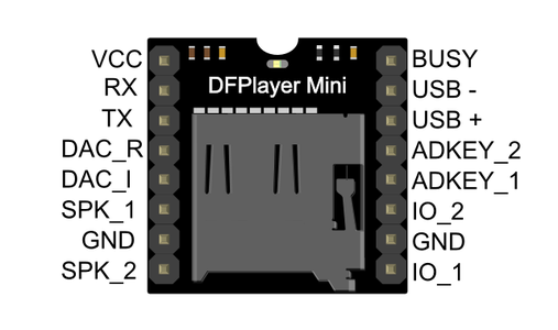

I then soldered a 1k Ohm resistor to the male end of a jumper cable and soldered a 47 Ohm resistor to a 10cm length of signal wire.
Now I added the jumper wires as shown to the Dfplayer mini card as shown on the diagram. You know you're doing it right when all of the jumper wires are on the same side - if not, take a look at the wiring diagram again.

The connections are:
Arduino Pin D3 - 1K Ohm resistor jumper to Rx on DFPlayer Mini
Arduino Pin D4 - jumper wire to Tx on DFPlayer Mini
Arduino Pin D6 - to one side of a 3.5mm switch jack - this will become the 'Next track' button.
Arduino Pin D8 - to one side of a 3.5mm switch jack - this will become the 'Play' button.
Arduino Pin D10 - 47 Ohm resistor wire to ground - this is needed to keep most battery banks active due to the low power draw.
The 5V connection on the Arduino to VCC on DFPlayer Mini
The grounds from the DFPlayer Mini and the two switch buttons need to be combined and fed into the Arduino ground. I combined them away from other connections and used some heatshrink to cover the connection to ensure it didn't contact anything else.
The speaker connections are wired from the DFPlayer through the headphone 3.5mm jack so this is always active, with the speaker negative passing through the toggle switch on the front.
