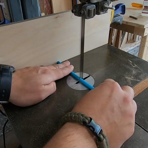

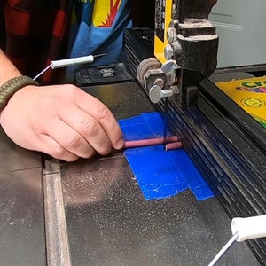

Cutting the coloured pencils seems like a super simple step and it would be if the pencils were not cylindrical. Cutting a cylindrical object on a power tool can be scary, but there are ways to mitigate your fears.
First I covered the throat plate with tape. This gave me a "zero clearance" area to minimize the pieces getting stuck in the cut. I then was able to set the fence to just over 3/4".
I tried a few different techniques to cut the pencils. Rolling the pencils gave a nice cut, but took a long time and often resulted in the piece flying backwards. Slow and steady worked alright as well, but I often found myself binding the blade a bit because I was not able to hold the pencil perfectly perpendicular to the blade. I tried cutting multiple pencils at the same time, but that didn't seem to work very well either. The technique that I preferred was to go quick and ensure I followed through and push beyond the blade.
Each coloured pencil is cut into 8 pieces. Don't try and cut the last piece with the sharpened end, just leave it a bit long and it will be sanded off later.
Another thing to be mindful of is where all the little pieces go! We set up a double bucket system, with a bucket hanging off the front and back. This way it was easy to push the pieces forward as you were cutting them and the few that went backwards were caught in the other bucket.

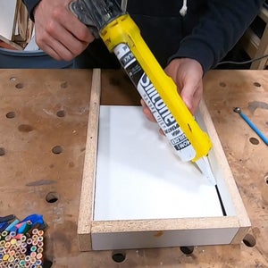

Even though melamine is very smooth and not much sticks to it, you still want to add a mold release. I used paste wax and just applied it with a rag.
The corners of the mold all need to have silicone caulk applied to them. If you don't apply silicone the epoxy will leak out.
After applying the silicone a fondant ball tool was used to create a perfectly smooth radius (better than you can get with your finger!). The round ball also cuts the silicone and squishes it out to the sides which will make removal easier.
Once the silicone has cured you can easily remove the excess without affecting the smooth radius. Just run a razor blade under the excess and pull it off.

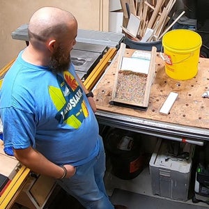

Step 4: Stacking!
This was a long and tedious process. The best way was to have the back of the mold raised so that gravity would assist you in keeping the bits in place.
What I don't show here (or in the video) is that I ended up doing this 3 times. The first time we forgot to put silicone in. The second time we poured too much epoxy and the pencil pieces started to float (but we didn't notice until it was too late) and then the third time was the charm!

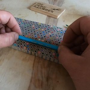

Step 5: Jiggling and Alligning
You want all of the pieces to be perfectly aligned with no gaps. We used a sharpened piece of scrap wood to push the pieces around until everything lined up nicely. Check your work twice as once you pour the epoxy there is no going back!

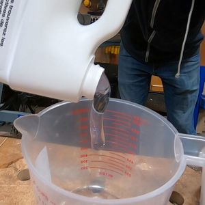

Step 7: Mixing the Epoxy Resin
Mixing the epoxy resin is really a science. We used ecopoxy UV resin and it is a 1:1 ratio of resin and hardener measured by volume. You should read your label and follow whatever it says as some epoxies are measured by weight and some have different mixing ratios.
We ended up making a lot of epoxy resin, way more than we needed for my project as were were making a few projects at once. So don't go by the measurements in the pictures.
Make sure to scrape the sides of your mixing container to ensure that all of the resin and hardener is mixed.

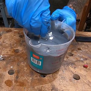

Step 8: Adding Pigment (optional)
Adding pigment or dye to your epoxy resin can add a bit of flavour to your project. We used some ecopoxy pigments and mixed white and black to make a dark gray colour.
Note: Preston recommended that I don't leave it clear as it often has bubbles showing. Despite his recommendation, I made one that was clear and he was right there are tonnes of bubbles as shown in the last picture.. I believe that this could be eliminated by either using a pressure pot or vacuum chamber (I don't know which would work better)

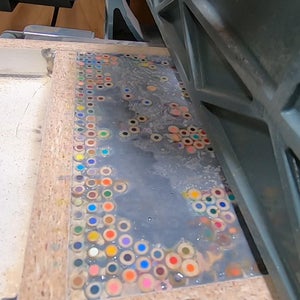

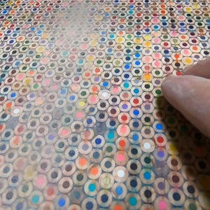

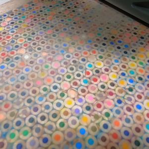

Step 10: Sanding the Top
Once the epoxy cures you start the long process of sanding. Using a drum sander we put the work piece through while it was still in the mold. This will give you a perfectly flat reference surface for when you turn it over.
Keep taking passes until all of the epoxy resin has been removed.

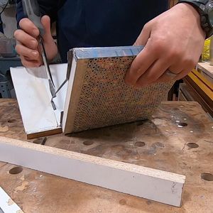

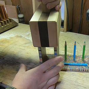

Step 11: Opening the Mold

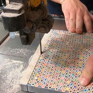

Take out your favourite mallet and give your mold a whack! Leaving the peices long on the mold allows you to get good leverage and makes mold removal that much easier. I used a flat head screw driver to remove the work piece from the bottom of the mold.
The last bit just wouldn't come off. Instead of risking breaking the work piece, I cut off the mold using the bandsaw. I then took it to the disk sander to clean up the cut.

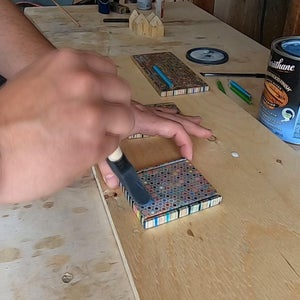

Step 18: Applying Finish
Before assembling the project I coated the entire thing in water based polyurethane. I did this before assembly to ensure that all of the piece was coated.
Step 19: Scraping Off Finish
Because I had coated the entire project with a top coat of finish I needed to scrape some of that off. If I did not do this step than the pieces would not actually be bonded together and instead would have been bonded to the finish and I was worried that it might pull off.
I used a utility blade to scrape off the finish and tapped it off on the area to ensure that I didn't scrape off any areas that wouldn't be receiving glue in the next steps.

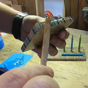

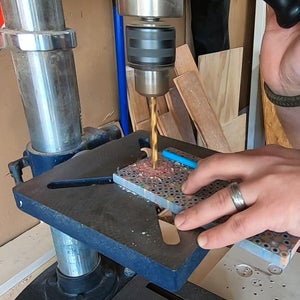

Step 20: Drilling for the Business Card Backer
To hold up the business cards I wanted to use half length pencils. So I first cut one of the extra pencils I had in half. I then sharped the piece that had two flat ends. Combined with the piece left over from a previous step, I had three half pencils.
I then located three spots on the work piece about 1" back from the business card stopper. I drilled three holes that were the same size as the pencils (1/4")
