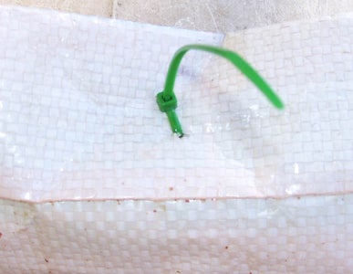

Step 6: Door
1. Get an old dog food bag made of tarp material or a scrap tarp.
2. (if dog food bag) Turn bag inside out and clean the oiliness from the dog food off with soap and water.
3. Place the clean dog food bag against the opening to the dog house.
4. Drill holes in sets of twos around the lip of the door. 5 sets of two should do.
5. Press the dog food bag around the door opening.
6. Locate the first 2 holes and use a wood screw to poke holes in the dog food bag that align with the holes you drilled.
7. Now string a zip tie through one hole and out the other securing your dog food bag door.
8. repeat until the door is secure all the way around.
9. Now cut a vertical slit down the center of the door flap.
