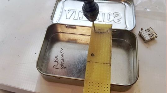

I cut two holes for the 3-way binding posts on end end of the tin and a rectangular cut out for the USB A socket. And a single hole in the bottom of the tin for the overcurrent LED.
I test fit the parts to make sure they fit.

Decided to build the system in an Altoids can on a perforated board.
Added the USB A socket first to the perf board, followed by the other components including the voltage converter board to the perf board. Used simple point to point wiring.

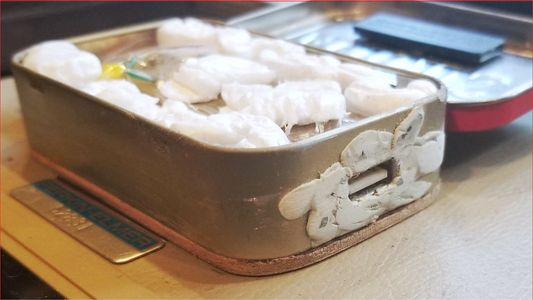

Connected the electronics board (wrapped in shipping tape) to the binding posts, filled it with Styrofoam peanuts to wedge the board in and hopefully prevent temperature fluctuations which may impact the accuracy.
Filled gaps with epoxy putty and sanded those smooth.
