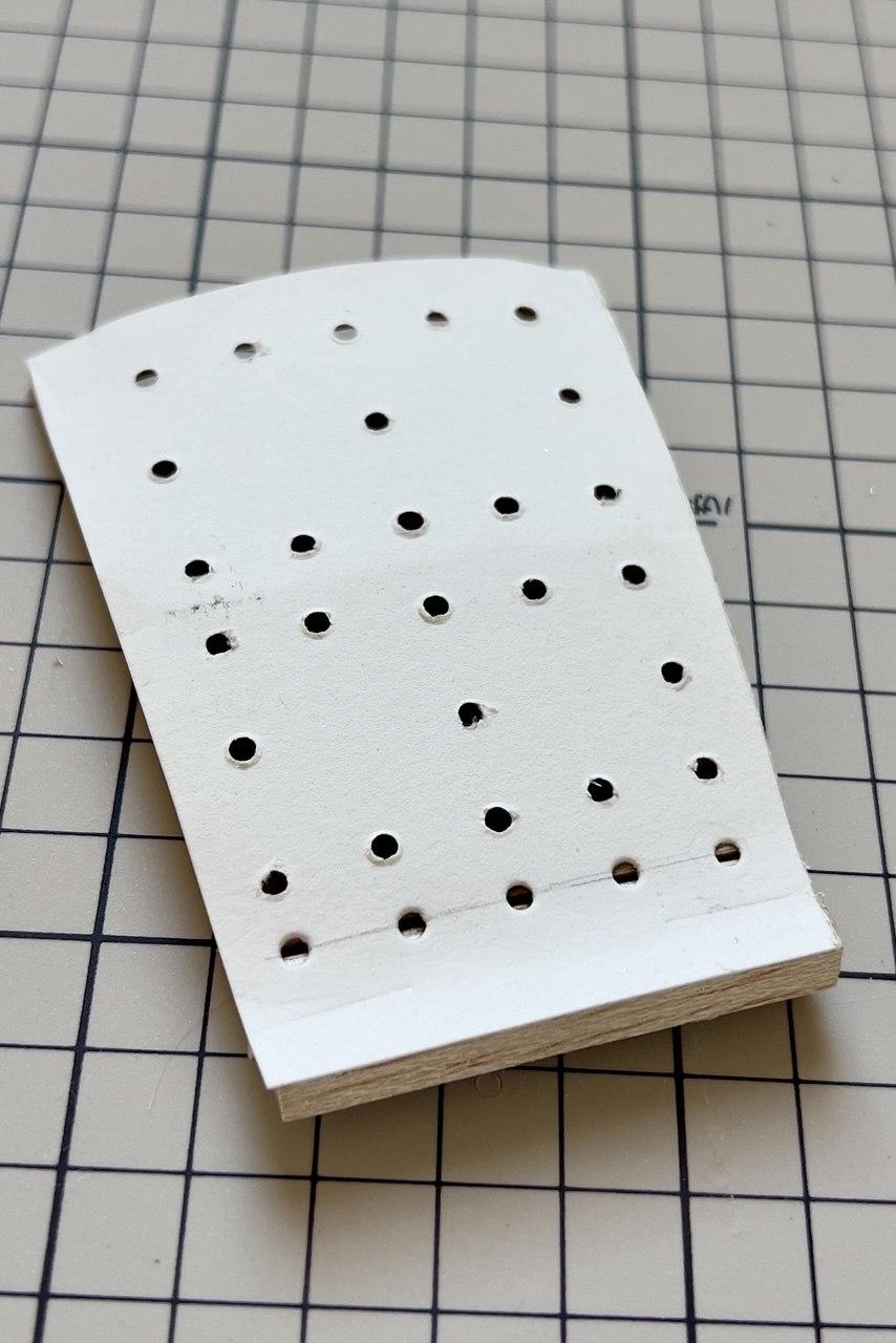

  1. Image 1: The back side of the cotton paper backing with punched holes for stitching.
  2. Image 2: Front view of the backrest, showing punched cotton paper aligned with the balsa frame.

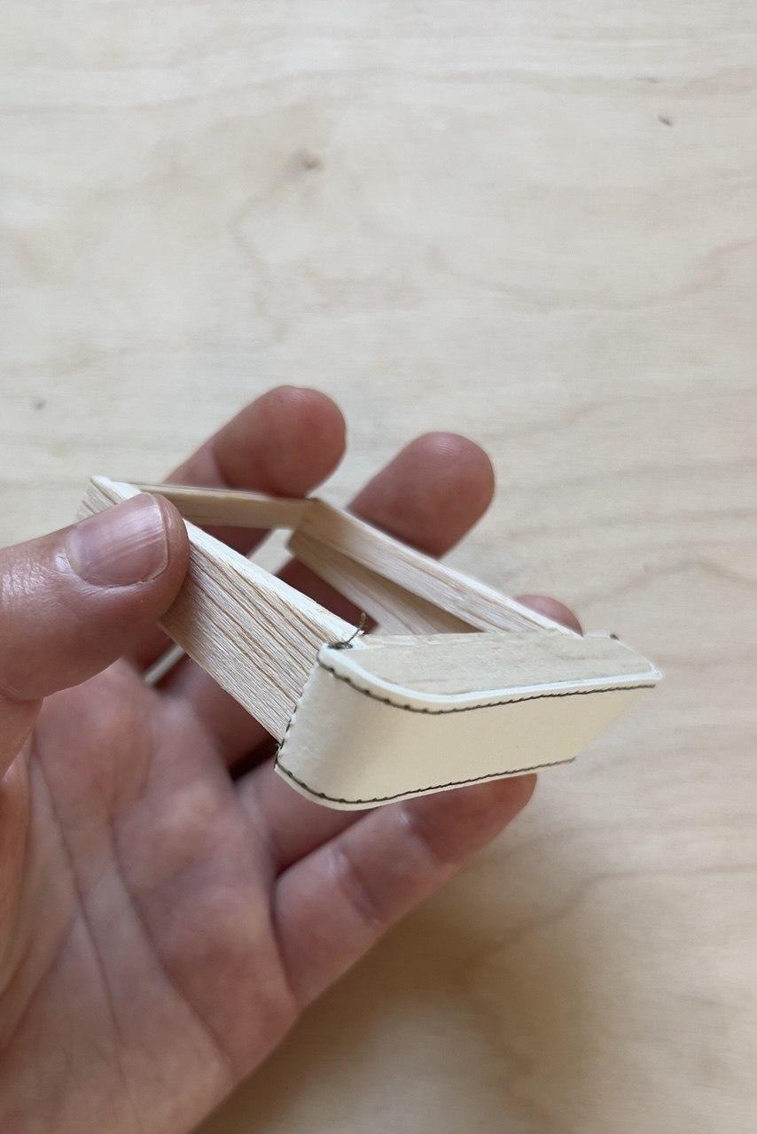

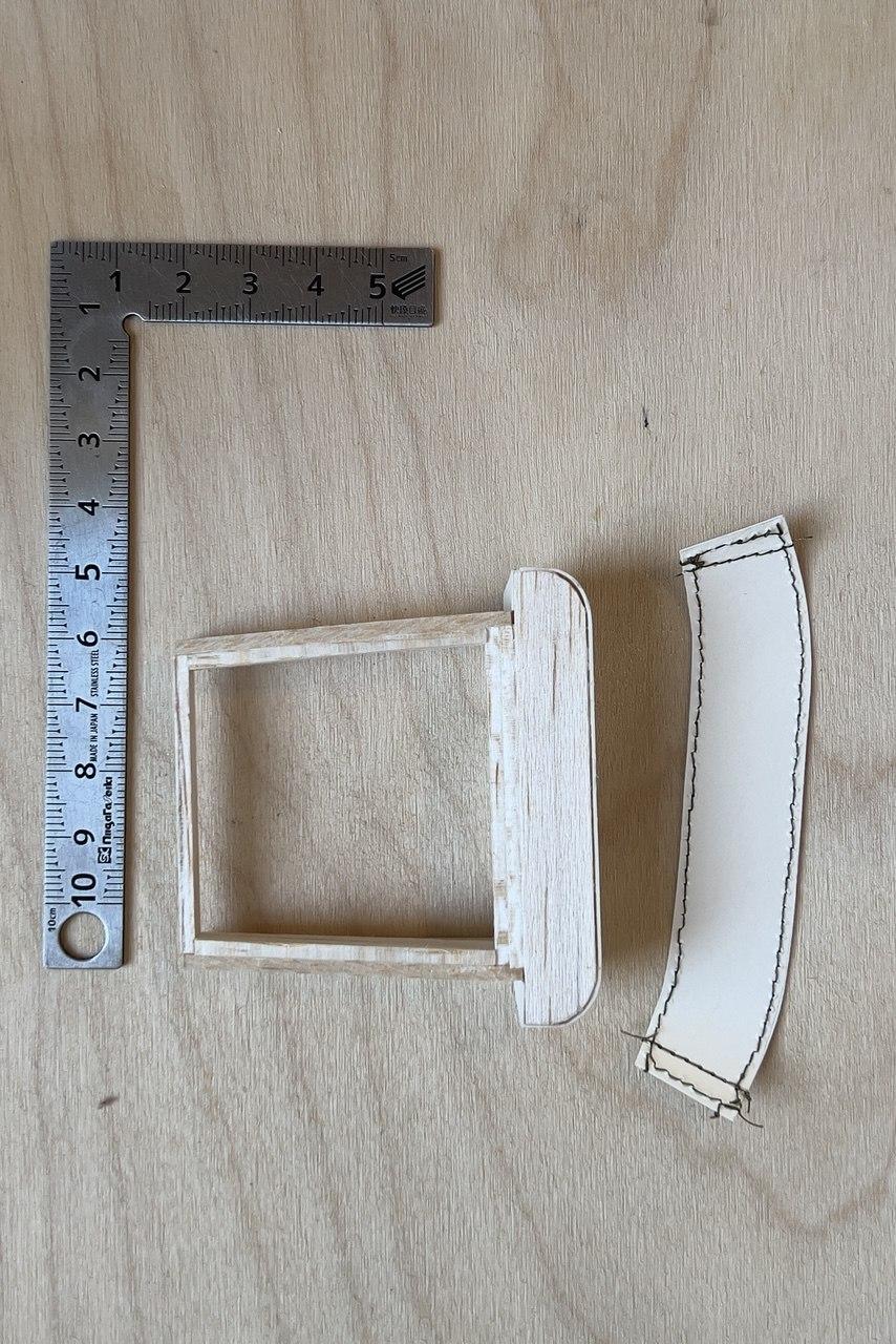

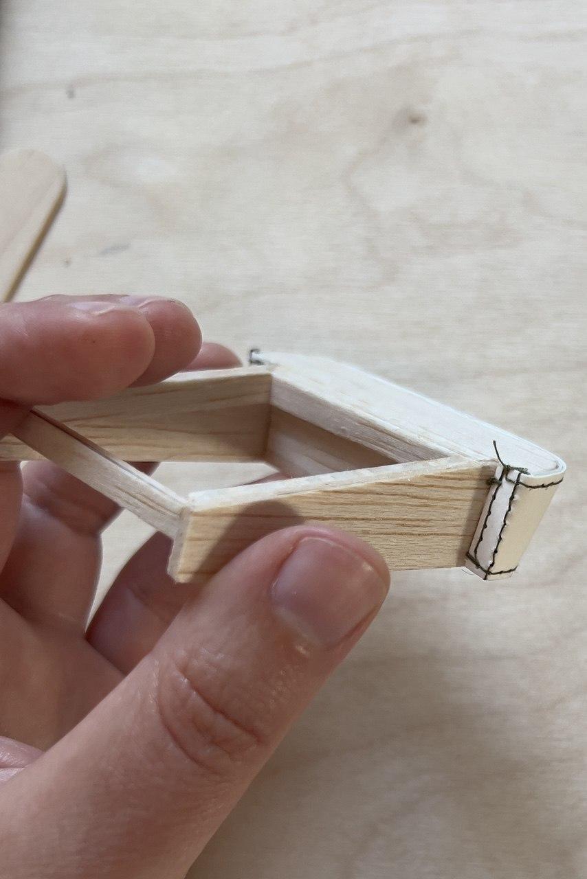

  3. Image 3: Close-up of the front base corner with stitched cotton paper, unglued.
  4. Image 4: The stitched cotton front panel fully glued to the base frame.
  5. Image 5: Front panel stitched but not yet glued in place.
  6. Image 6: Top strips of the base section stitched and prepared for future fabric upholstery.

  1. Cut wool into a rectangle that matches the shape of the back in layers.
  2. Stitch wool into place using pre-punched holes in the cotton anchor paper.
  3. Needle-felt the surface lightly to refine bulk.
