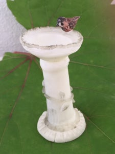

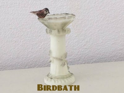

Step 8: Finally Finally.......
the bird bath is actually ready to use...however it looks very new and unused.
I pulled out some eyeshadow- an olive green color , brushed it briskly all over the relief to deepen the features.
This kind of gives it a mossy, used kind of look.
Bake the sculpture at 110C for 15min.
Step 9: Using It!

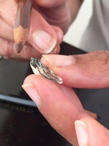

What use is a tny birdbath without any tiny birds. I made a tiny sparrow to enjoy a good bath.
I will not add the sparrow making instructions here or else it will be a never ending story(just putting up some pictures.)
