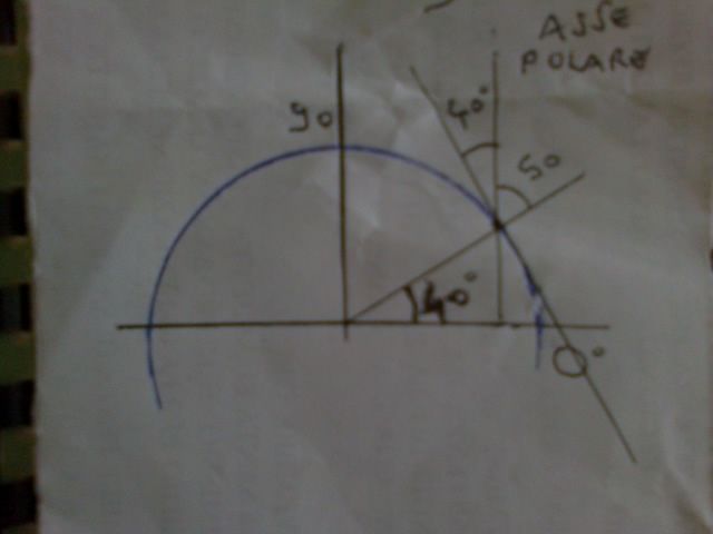

Step 15: (11) Use Marks With the Equatorial Mount
Usually one may hesitate to setup the equatorial mount because of the steps it needs. However it is a very basic and useful thing to learn how to do because you can handle the scope better in large magnifications. Bresser has included in the construction helping marks (on the rod and on the main axis) and the procedure is easy.
I found very helpful to make an orthogonal triangle with the angle of my altitude location (Athens 38 degrees). I also marked this angle with a small piece of paper tape on the rod which keeps the equatorial plane in position. This saves some time in the dark.
