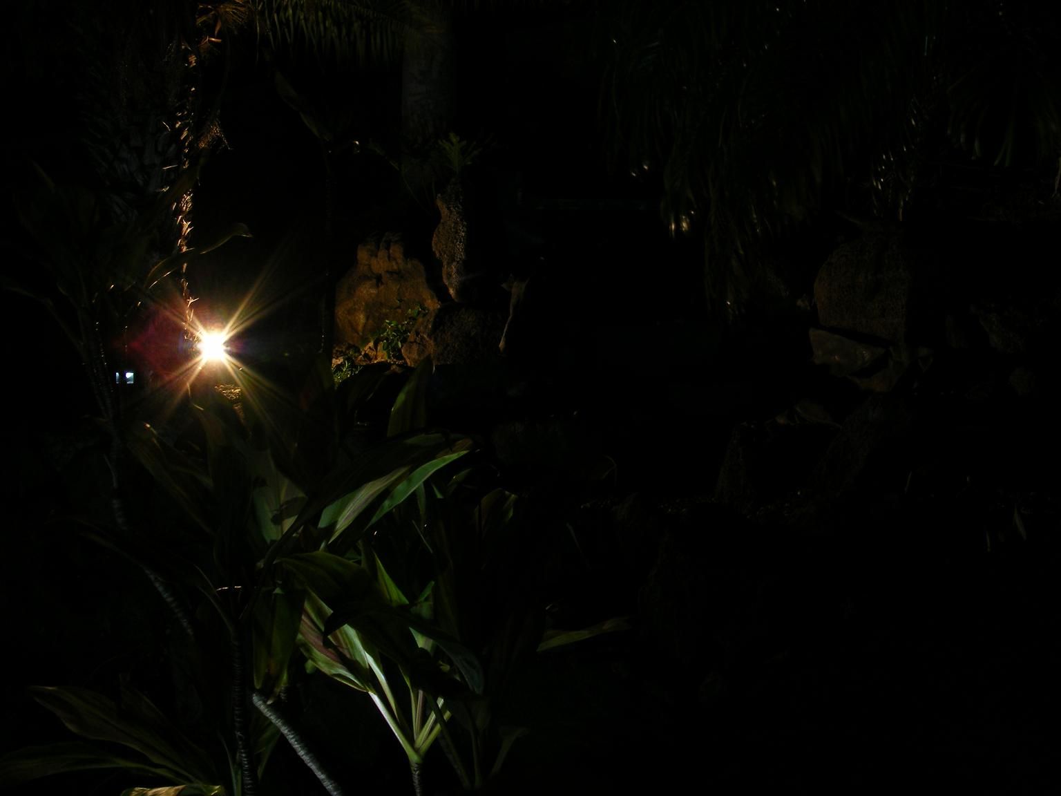

There ya go. A 12vdc 40W light bulb that only uses 190ma. The possibilities for this bulb are endless. Hope i at least gave you some ideas:)
