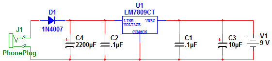

Introduction: 120VAC to 9VDC Power Supply
Use This Power Supply Instead Of Wasting You money and buying 9V batteries. I have made many 9V Power supplies. but this is the simplest. Check out my facebook fan page: ElectroPCBJared for other schematics and PCB layouts.
Links:
2200uF Capacitor - http://www.jameco.com/webapp/wcs/stores/servlet/Product_10001_10001_30533_-1
2X .1uF Capacitors - https://www.jameco.com/webapp/wcs/stores/servlet/ProductDisplay?storeId=10001&langId=-1&catalogId=10001&pa=151116&productId=151116
10uF Capacitor - https://www.jameco.com/webapp/wcs/stores/servlet/ProductDisplay?storeId=10001&langId=-1&catalogId=10001&pa=29891&productId=29891
LM7809 - https://www.jameco.com/webapp/wcs/stores/servlet/ProductDisplay?storeId=10001&langId=-1&catalogId=10001&productId=1958641
1N4007 Diode - https://www.jameco.com/webapp/wcs/stores/servlet/ProductDisplay?storeId=10001&langId=-1&catalogId=10001&pa=36012&productId=36012
Battery Snap - http://www.jameco.com/webapp/wcs/stores/servlet/ProductDisplay?langId=-1&productId=109154&catalogId=10001&storeId=10001&krypto=9x3mj8umRToOo%2FPxUybmkqZ%2FRhqgXIr80OawEamCRP8%2B1H9m5rBqLz2JSNVz9JnL3VICC4UgtvxM%0D%0AKg6NfU3Y%2BqVrNFY3MhPQ&ddkey=https:StoreCatalogDrillDownView
DC Jack - http://www.jameco.com/webapp/wcs/stores/servlet/Product_10001_10001_101186_-1
Wall Plug - http://www.jameco.com/webapp/wcs/stores/servlet/Product_10001_10001_189238_-1
