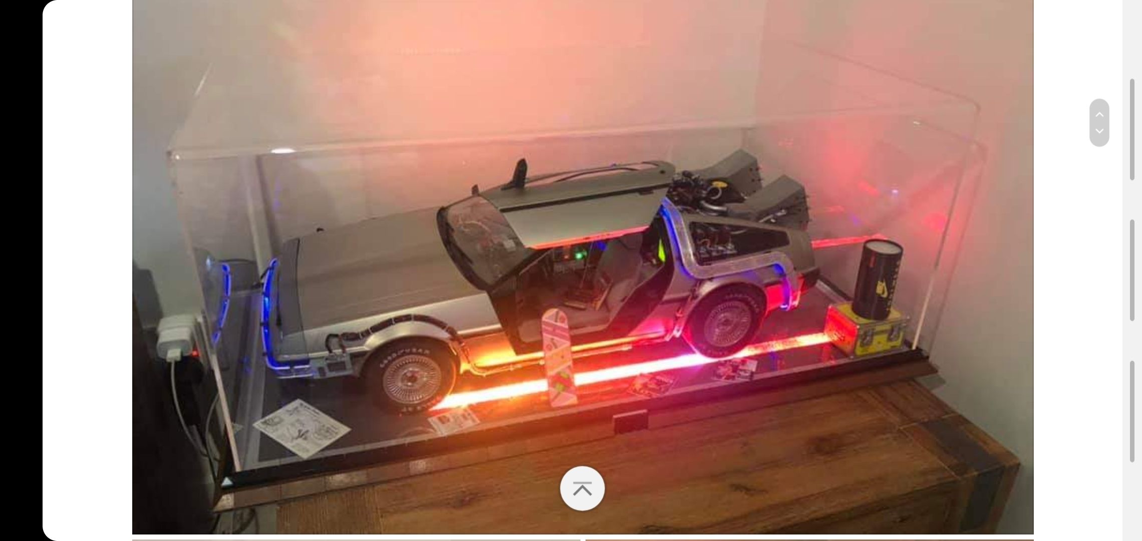

Hi thank you for this detailed working,
Iam no expert in this so i don't know much, iam build a back to the future delorean and some people have built using this tech the flames see pic.
Now I know that these have to be programmed, I've sourced all the bits you have mentioned, the question is please how doni program them.
Thank you
