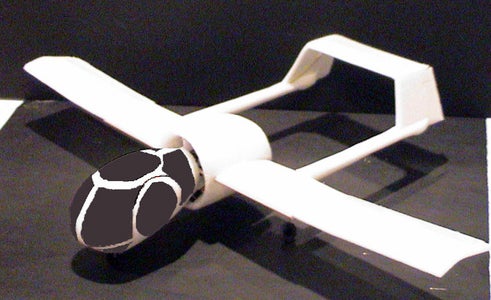

I have been collecting information on this unusual aircraft for over 4 years. I first saw it in a movie called “slipstream”. The Optica was first flown in the public at the 1979 Paris airshow. It was four years later at the 1983 Paris airshow before the company was able to take orders. The plane is ideally suited to slow observation flying, filling the void between helicopters and light aircraft. By 1987, four aircraft had been sold. The fourth plane was placed in trials by the Hampshire police department. Unfortunately, the plane crashed killing all aboard. Investigation cleared the plane from fault, but the delay cost the company. Updated versions were built and the company was bought by Brooklands.
A fire destroyed many of the built and partially built planes. Today there are a handful of planes flying keeping the legend of the Optica alive. Rumors abound about it’s revival. Until then, I will build models.

The fan shroud and canopy are carved from 1 ½ pound styrofoam block. A solid block would be best but laminating two or more works well also. Do not use white glue to laminate foam where you plan to sand. White glue does not sand well. Epoxy is the best bet here. The Canopy is best carved from two blocks held together with contact cement. This allows the blocks to separate to fit on each side of the crutch. Carving may seem daunting but it is easier than it looks. Trace the outline of the part on the sides and the top and bottom. Slice away foam that does not fit inside the outlines with a sharp hobby blade. You will see the shape take form soon.
Step 2: Shaping Canopy and Shroud
Complete the parts to their final shape using course sand paper. Use fine sandpaper to smooth the foam. Light weight spackle can be used to make it smoother. To harden the foam, I used white glue spread over the surface. Once dry, there is very little weight added.
Step 3: Interior Shroud
A long hobby blade is used to carve out the center of the shroud. A rough file helps remove foam from the inside followed by fine sandpaper wrapped around a dowel. Be sure to form a “trumpet” on the leading edge of the shroud. This helps smooth air get to the fan. Fit the fan into the rear of the shroud with the rear flush.

The CG is 1 ¼” behind the leading edge. The battery placement will adjust the CG. Tape the battery in place. Adjust the elevator and aileron throws to ¼” both directions. The small wheels will require a smooth surface to take off. Roll out is about 50 feet to get up to speed. It handles the wind surprisingly well. It will loop and roll but inverted flight is not what the Optica is meant to do. The real plane is a stable observation platform. The model carries on the stability. The Optica model is not twitchy as you might expect from a small 4.3 ounce model.
