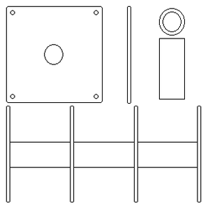

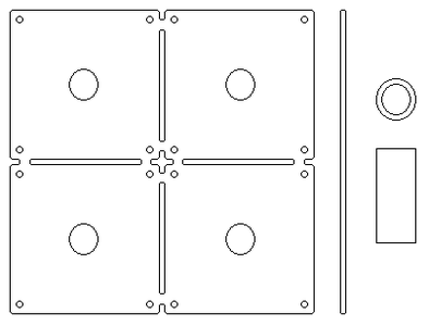

To design this barrel assembly I started by first drawing it in 2D.
Then I did a 3D drawing in 2D
Step 4: Autodesk 123D Beta
I like this program it is free with on line tutorials and it is easy to use. Once I made sketches I opened Autodesk 123D Beta on my computer and designed my 3D print in an hour this prints 4 sections of the barrel at a time. I can’t wait for my parts to come I NEED THE PRINTER.
