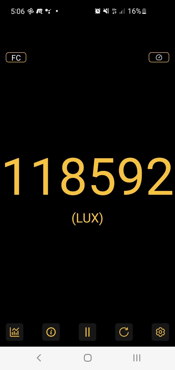

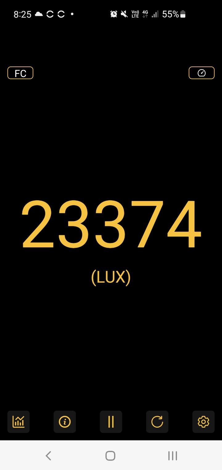

The amount of light there is when taking a photo can vary greatly and it can be difficult to judge with your eyes. So, I downloaded an app called 'Light Meter'. This shows how much light there is. The unit used to measure light is the lux, where 1 lux equals the light from a candle at 1 meter away. I am still amazed at the vast change in light depending on the circumstances. Here's some examples...
Light in lux:
Direct Sunlight 32,000 to 140,000
Ambient Daylight 10,000 to 25,000
Overcast Daylight 1000
Sunset & Sunrise 400
The vast difference in the amount of light, depending on conditions results in pinholes exposures times from a few seconds during sunny days to 15 minutes and above for indoors shots.

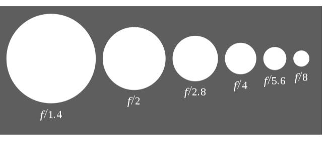

These large changes in lighting conditions encountered, is reflected in the f-stop aperture scale used in photography. Each stop number is twice the size of the one before it. e.g. f2 is twice the area to f2.8. A smaller number represents a larger opening.

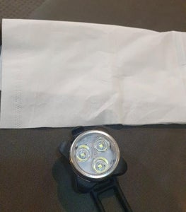

After the photos were taken, the roll of film was removed from the pinhole camera in a change bag, placed into a developing tank and developed using a mono-developer. After it had dried, it was scanned using my phone camera and a bike light. A piece of tissue paper was used to defuse the light. I am sure there are better ways to convert the film into digital format, but I don't have that gear. The images were then converted into positive ones using an app called Negative Image.

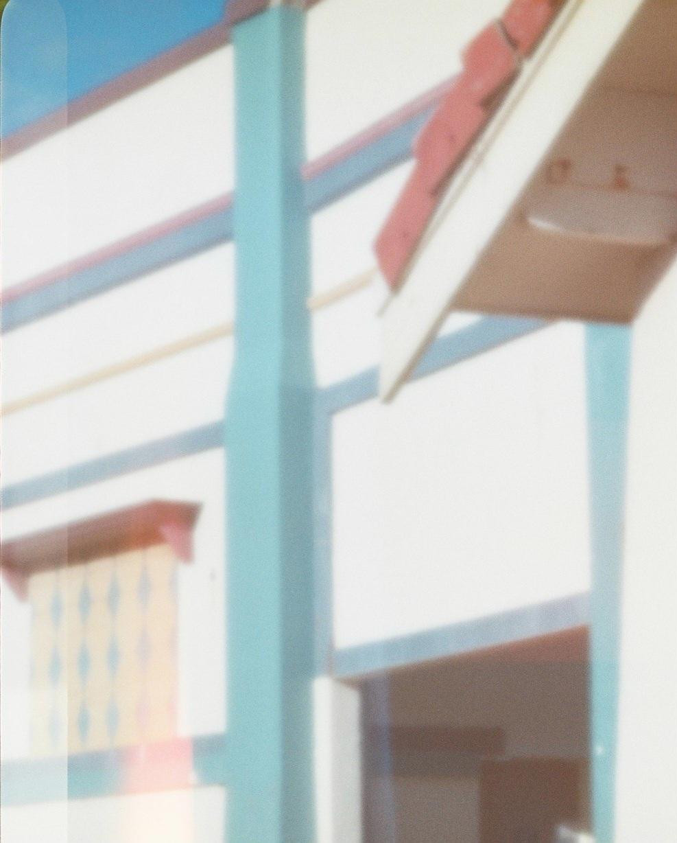

A roll of Color (iso 100) 35mm film was installed into a used 126 cartridge. The film was developed at a camera shop. This pinhole camera had a 70mm long body compared to 50mm for the black and white pinhole photos. The longer body narrowed the field of view and made the images look closer, but it also made composing the photos more hit and miss. Most of these images had an exposure time of 10 seconds. The fence 5 seconds and the white sign 2 seconds.
