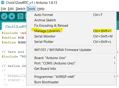

Install all library like AdaFruit Neo Pixel and RTCLib library through library manager of arduino IDE. (Tools->Manage Library)
Just upload attached clock12LedRTC_v1.ino file through Arduino IDE or through create.arduino.cc with correct selection of COM port on your windows computer.
If you have already connected Uno to USB port of computer before start of Arduino IDE, it will select board and port automatically most probably in Windows 10 machine or if you have previously connected, it will auto detect it.
If all works fine, just compile and upload Clock12LedRTC_v1.ino sketch to Arduino ...
